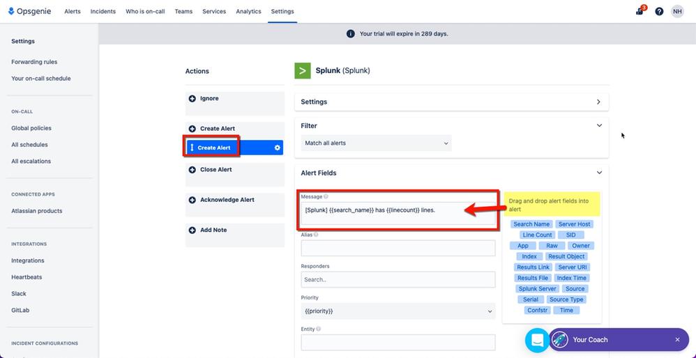

When alerts get created in Ops Genie from the integrations i have added, how do i configure the error message so it allows the person dealing with it to understand the issue in an instant?
We have a splunk integration which states 'Website Performance has lines'
Where can i amend this error.

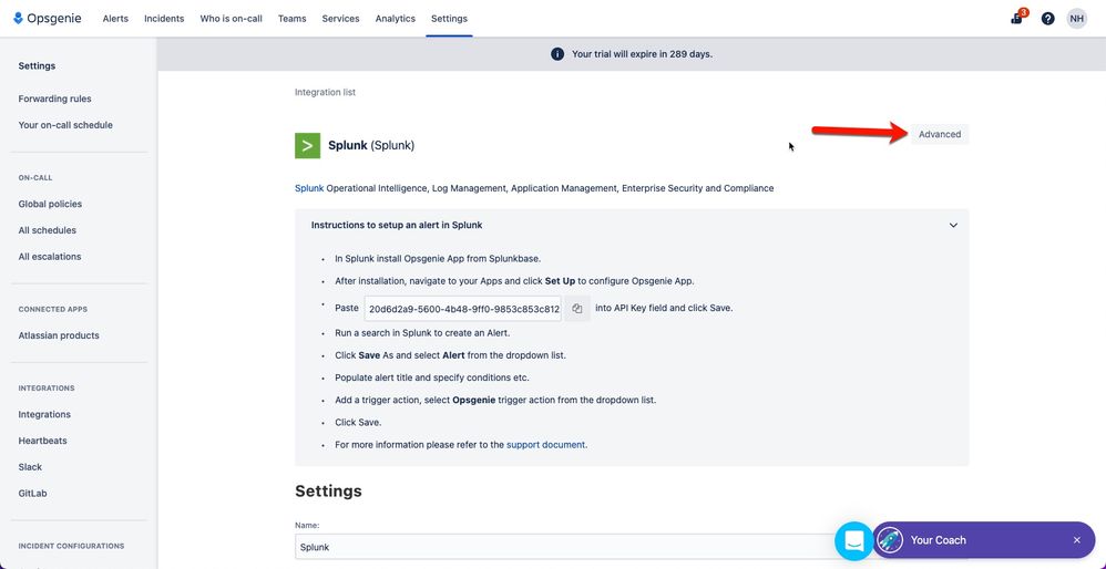

Hi @Jason Selby ,
You can configure what data parses in the alert's message under the integration's Advanced tab > create alert actions' Message field.
Note that this tab is only available on the Opsgenie standalone Standard and Enterprise plans, or the JSM Premium and Enterprise plans:
