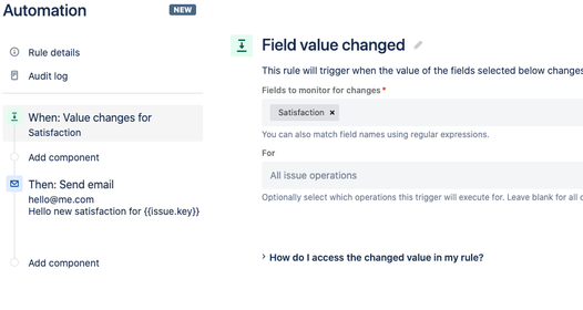

I have satisfaction ratings switched on my account. So every-time an issue is resolved, Jira sends out a survey back to the customer asking feedback. What I want is, when a customer chooses to provide feedback, for Jira to trigger an email to me (administrator)

Sample Recipe for Jira Automation
When: Value Changes for "Satisfaction"
Then: Send Email to you / Administrators

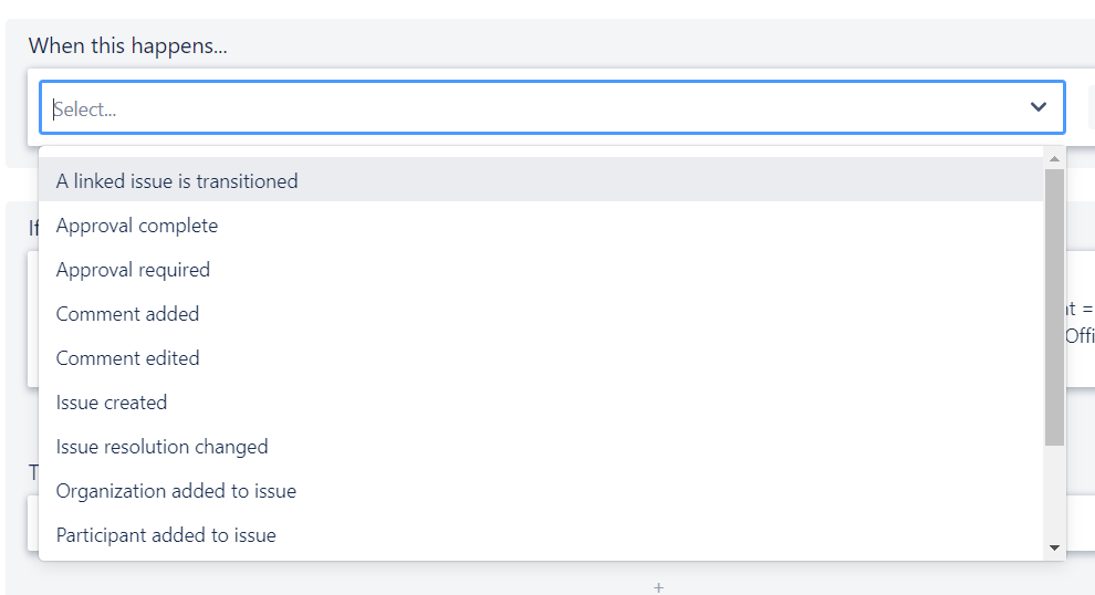

@Robert Levelind where from are you doing this? I don't have a "Field value changed" option in automation. I went to project settings - automation. Is this the right place?
Maybe it is not possible in cloud?
Robert Levelind
July 21, 2020
@Kerli Loopman
If you scroll down in your Project Settings you will first see "Automation" which you are currently using.
If you scroll a bit further you should be able to see another section called "Project Automation" which is the newer (and in my opinion better) automation engine :)
Kerli Loopman
July 21, 2020
Thank you, never noticed that one. :) Will start to explore it now.
