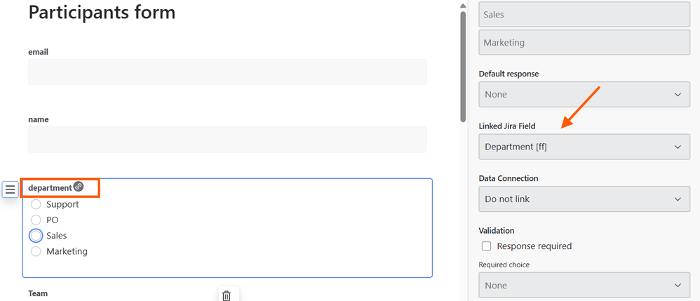

Have you linked the fields from the Form to their corresponding custom fields on the issue view?

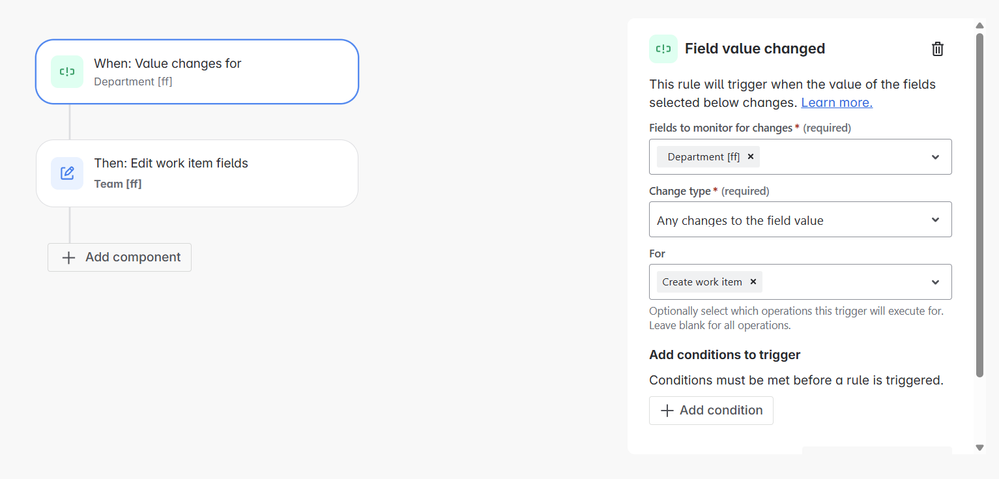

I suggest linking a field from the Form, e.g. Product Area, to a custom field available on the given issue view (preferably with the same name and options). Then you can create an automation:
When: value changes for Product Area; for create work item
Then edit work item fields

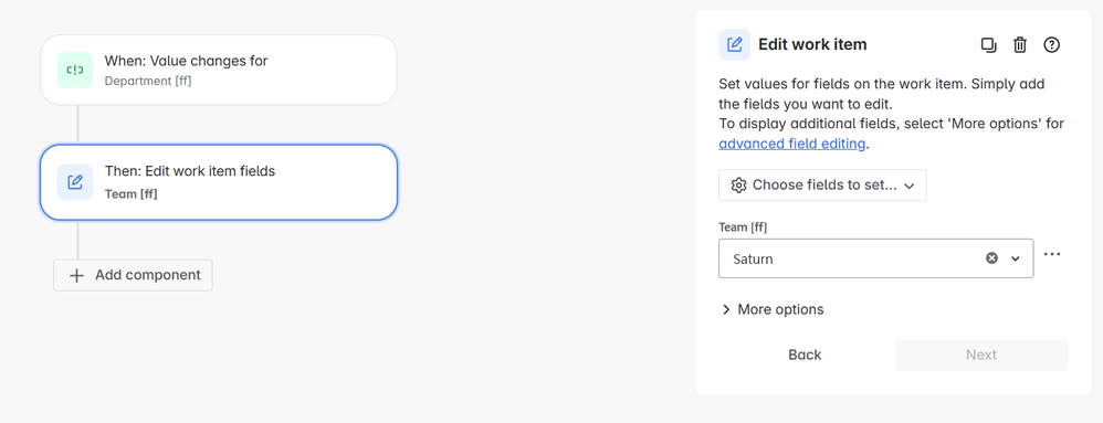

Here’s an example where the automation updates the Team field based on the Department field.
The Department field is a custom field linked to a field from the Form.
Result: After filling in the Product Area field on the Form and creating the work item, the value of its corresponding custom field will be populated.
Then, based on this value, the automation will assign the selected values to the fields specified in the rule.
