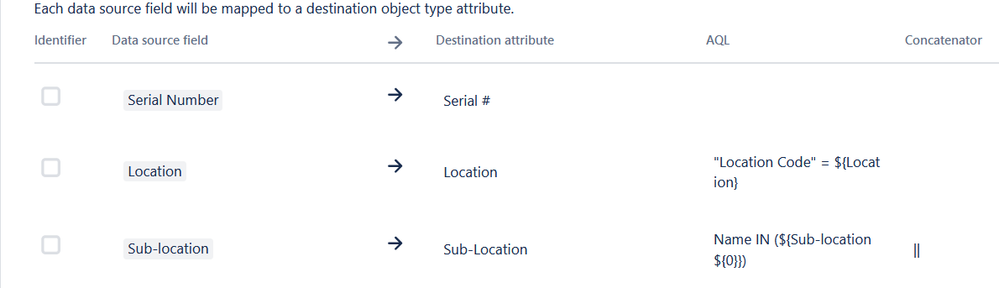

For multiple references, use double pipes "||" as the concatenation character in the CSV file. Then, when you set up the import and edit the mapping, use the same double pipes in the Concatenator column.
Keep in mind, that the column "Data Source Field" is for the headers in the CSV file and it is the value referenced in the AQL along with the object attribute:
<object attribute> IN (${<data source field>})
Here is the associated csv file:
So, in essence, if you need to have multiple entries into an object that can hold more than 1 object, then make sure that the column for that single object has all the selections separated by the double pipe "||".

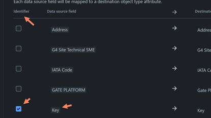

Hello @John Doe . Can you send a screenshot to verify your issue? With that being said, it sounds like your identifier is using the wrong attribute. Go and check your import settings for this object by going into schema configuration > import > edit mapping > edit attributes mapping. Look for the attribute with a check box in the identifier column
In my pic example, all items with a unique 'key' attribute will be separated into a unique object (record). If I changed it to Address, then all unique addresses will be a unique object when I import the objects. Hope this helps!

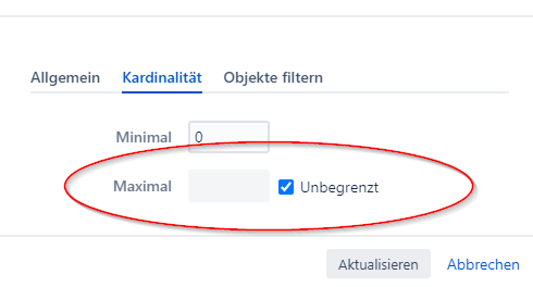

It works for me exactly with your import phrase.
But I once had the same problem: Then I forgot to change the destination attribute (the first "Department" in your case) with Cardinality type to "Unlimited" (screenshot only in German).
Thanks for the tip, unfortunately I had already checked “unlimited” so that’s not it either :/
