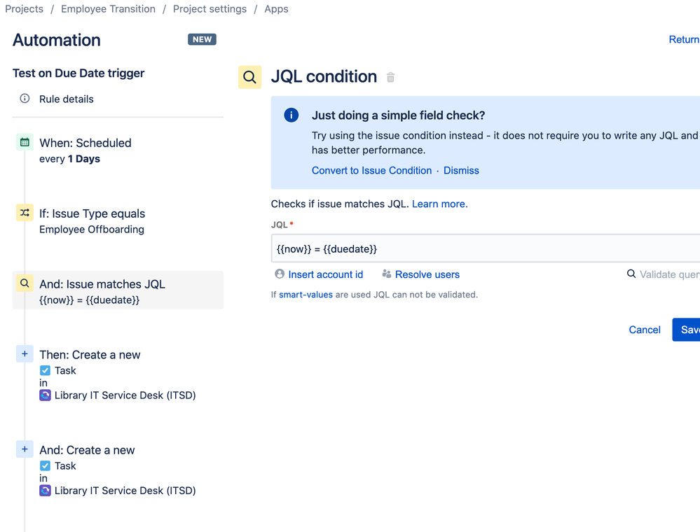

I am using the HR Service Desk. An exiting employee has a resignation date and a termination date. I have a couple of questions:
It will look something like this although this one does not work.

Per your description and rule, I understand that your final goal would be to create an automation rule that creates two new tasks for each existing task that has reached its due date. Is that correct?
Based on that assumption, I'll try to properly answer your questions and give you the correct instructions to achieve your goal:

How do I set up the automation to run when the termination date is today?
The logic of the automation rule you created seems to be correct, however, there are some minor JQL errors. Please, create the rule following the template below:
If you are trying to achieve something different, please give us more details of your final goal so we can properly help you.

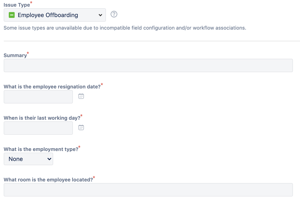

That was helpful. When I follow your example, it does not give any errors which is a step in the right direction. When I run the rule, it does not give me the result though. Here is part of the form that creates the ticket.
Since this was a default request type, I looked in Admin | Issues | Custom Fields and found "Last working day" as the field name.

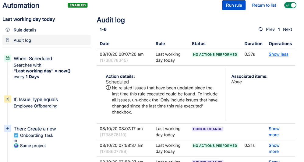

I created a test ticket with today as the last working day and then created and ran the rule that is similar to yours, but it doesn't return the results.

Hello @Margaret Winward
As displayed in the rule audit log, the JQL query you added didn't return any issues that were updated after the last time this rule was executed. This mean two possible reasons:
"Last working day" = now()If the filter does not return any issues, you might not referencing the correct field there or you don't have any issues which "Last working day" is today.
Let us know if you have any questions.
The wrong field was selected. Your troubleshooting process helped me find the correct one. Thank you!
