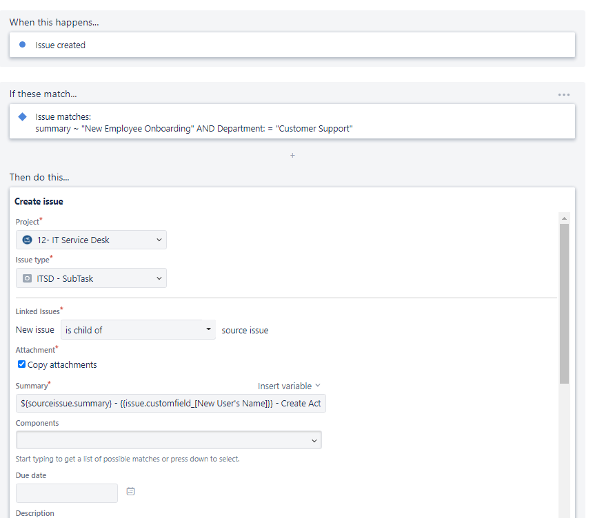

I have been working on setting up an on-boarding process for my company in Jira Service Desk. I created a Request type to capture the basic data needed for the new user.  I.E. name, position, supervisor, department...  I am then using Automation to generate sub tickets for the account types the user will need.  I would like to setup the summary on the child tickets to capture the "New User's Name"  filed from the parent.  I curently have this value ${sourceissue.summary} - Create Needed Account in the summay and it works fine for pulling in the parent issues summary.  I have tried adding smart values such as ${sourceissue.[New User's Name]} and ${issue.parent.[New User's Name]} but it just adds this text to the summary filed not the desired text from the parent issues New User's Name custom filed.  Any help would be greatly appreciated.

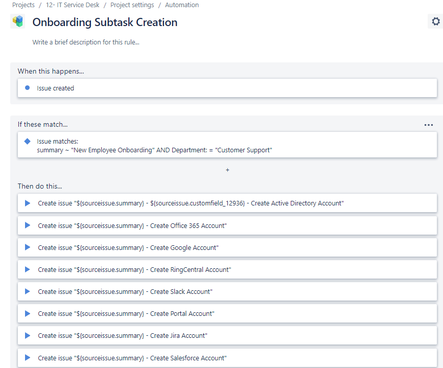

Thanks for the response. I attached a screenshot of the automation below.  I tried your suggested smart value syntax but it was just displayed on the summary line.

I updated the syntax to ${sourceissue.summary} - {{issue.customfield_[12936]}} - Create Active Directory Account, but still getting the same results.
Zack Shepherd
October 30, 2020

So that would be ${sourceissue.customfield_12936}

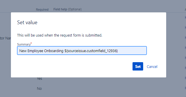

I tried applying the syntax to the prefilled subject line of the Request Type. Jira4.pngI also tried using ${issue.customfield_12936} both failed.

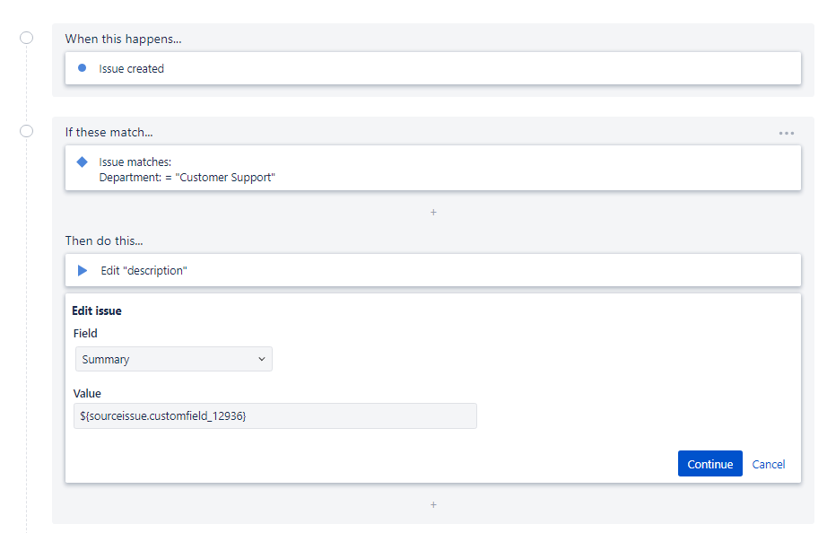

Next, i tried the syntax on a rule that edits the description of the parent ticket.
jira2.pngThis produced the same results.
Finally, i tried applying the syntax to the subtask creation rule but no luck there.
