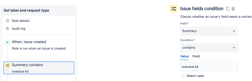

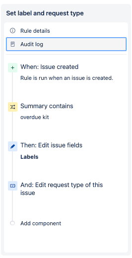

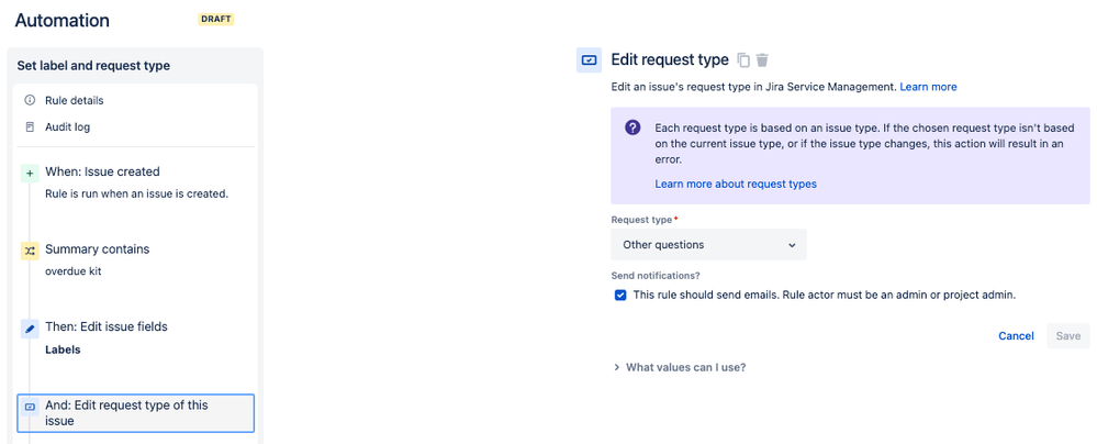

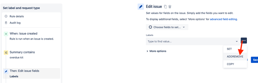

This would be the automation for setting the Labels and Request Type for a newly created issue that has "overdue kit" in the Summary field.
