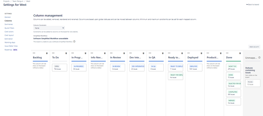

So I created the new workflow, created the scheme, associated them, and applied to my projects. But the statuses are still not showing up. I go to board settings, added the new columns, but there are no statuses to drag into the columnworkflow 1.PNG
Walter Buggenhout
November 3, 2020
Ok @Samuel Justus,
Thank you for sharing the view of your board. Apart from the fact that I see the Deployed status mapped to the Done column, I can see that you have a few columns with no associated status indeed. In order to be able to help you, I have a couple of questions:

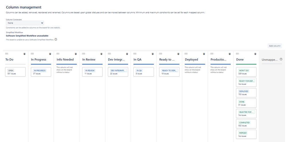

I moved deployed to the deployed column, thanks,
1. The statuses are the same as the empty column names.

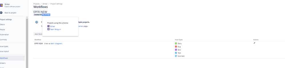

3/4. The workflow scheme and the workflow are both named the same, and both are already associated with the specific project. The screenshot above is from "Striker" projectworkflow2.PNG

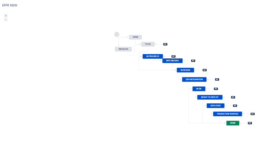

  • if you click on the diagram link of the EPFR NEW workflow from the view you shared on that last screenshot, does it show the missing statuses?
  •  and yet again: can you have a look at the filter behind your board (which you find through on the general tab of your board settings) to make sure there are no statuses being explicitly excluded from your board?
Samuel Justus
November 4, 2020
Yes, all the missing statuses appear in the diagram.

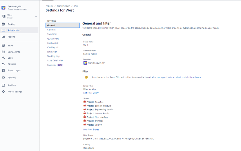

I looked at the filter, it says the following "Some issues in the Saved Filter will not be shown on the board. View unmapped statuses which contain these issues."
The link takes me to my board with the columns and missing statuses

So, in order to help me help you, can you please share the exact filter behind your board as a starting point. It will help me understand where the underlying data comes from that you are pulling into the board and narrow down into the problem.
A screenshot of the general tab of your board may be just the thing we need.

So, here is the General tab...

From there, if I click on the link under 'Filter', it takes me here...

If I go to 'Workflows' in Project Settings, I can see that the correct workflow and scheme are added.
Here is the diagram of this workflow, with all statuses and transitions mapped

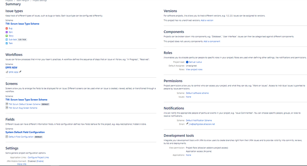

And here are the other settings, in case there is anything here that might help

I see that - despite your board is located in the Team Penguin project - both projects that you assigned the new filter to are simply not in your board filter.
From the screenshot of the workflow, I can see that the workflow is being used in 2 projects: Team Penguin and Striker.
None of those projects are associated with your board, as you can see in the board filter, which is:
Project in (TRIMTABS, EAD, IA, BER, NI, Analytics) ORDER BY Rank ASC
So to solve your problem with the invisible statuses, update your Board Filter by clicking Edit filter query under Saved Filter. You should at least include 1 of the 2 projects that have the new workflow in order to make the new statuses show up in your board.
