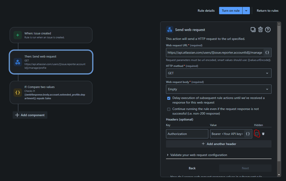

Micah Harley
January 27, 2025
Old post, but it's still at the top of google, so here's how do to this now... basically still same solution, but updated link and an example...
The endpoint to get user profile data is:
https://api.atlassian.com/users/{{issue.reporter.accountId}}/manage/profile
Doc is now at here.
You need an Organization API Token to call it. This is different than the Jira API Token. You will also want to make sure "Delay execution..." checkbox is ticked, so the rule won't keep running without the response. Also, hide your authorization header...
The response contains the Department in :
{{webResponse.body.account.extended_profile.department}}
After that, it's pretty straightforward:
