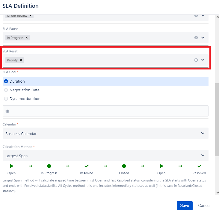

Based on the comment made here, I believe there are two possible configurations.
  • SLA Pause: Define different SLAs for each priority and pause the SLA when the ticket's priority is changed. For instance, P1 SLA will pause when the priority is not P1. This set up looks flimsy since when the priority is changed the service level agreement changes so there is no need to keep data of the previous SLA.
  • SLA Reset: This is not available out-of -the box but you can use Time to SLA . You can define different SLAs for each priority and set the priority as a Reset condition so that when the priority changes, previous SLA invalidates and the new SLA starts counting according to the new priority of the ticket.
priority reset.pngLet me know if you have any questions.

@Gökçe Gürsel {Appfire} Thanks! Will give this app a try.

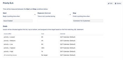

Hello Carlos,
It's possible to add different SLAs for each priority and once it's changed, the SLA won't be reset.
Actually, it's not possible to reset an SLA. There is a feature suggesting this:
I created this SLA as an example:
When changing the priority, just refresh the page to see the changes.
Please, give it a try and let us know how it goes.

Thanks! Unfortunately, this will not preserve the old SLA time from previous priority though :(
