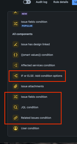

I tried using IF rules with these components, with and without branches, but I can get the automation to stop working.

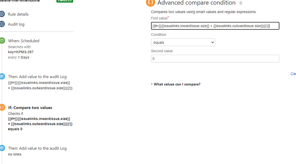

Probably many ways to do this but one way is:
Use the  if -> "smart values condition" and check if:
{{#=}}{{issuelinks.inwardIssue.size}} + {{issuelinks.outwardIssue.size}}{{/}}
EQUALS
0
If so, you continue your steps, else it will exit the If condition.
Please see screenshot for example. Its DC screen but cloud should be same.
Hope it helps. Thanks!

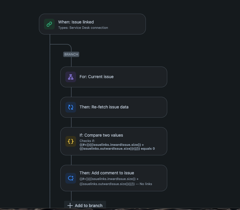

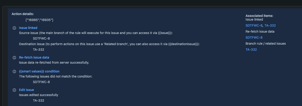

I tried your solution, but for the Service Desk ticket I can't even manage to get a comment published - so the formula doesn't work.
I'm starting to think that it doesn't work perhaps because I'm trying to make changes in both a Jira project and in a Service Management one via one single rule?
Here's the configuration and the logs, perhaps you can share some more insights? Screenshot 2024-05-23 at 11.05.51.pngScreenshot 2024-05-23 at 11.05.39.png

The If condition should be right after the trigger, not inside the branch.
Also, I am not sure why you need a branch.
