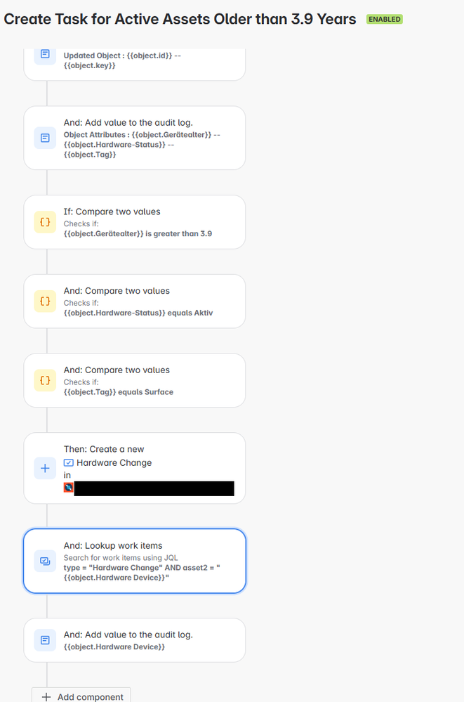

I have built a rule that creates a work item when an asset is older than 3.9 years. Every time the asset is updated, a new work item is created. And I would like to have a query that first checks if there is already a work itemwith the same name, if yes then no new work item should be created.

Antonia
July 16, 2025
Hi @Marc - Devoteam
thanks for your help.
The based on IF/ELSE, if already found add for example a comment to the issue ELSE create a new issue.
What do you mean by that? Do I usually have to create a new component for this or can I enter it in the field for the JQL? I've also looked at the other post, but I don't quite understand it, I can't really get any further. I would prefer it if the action simply checked whether the summary/title already exists.

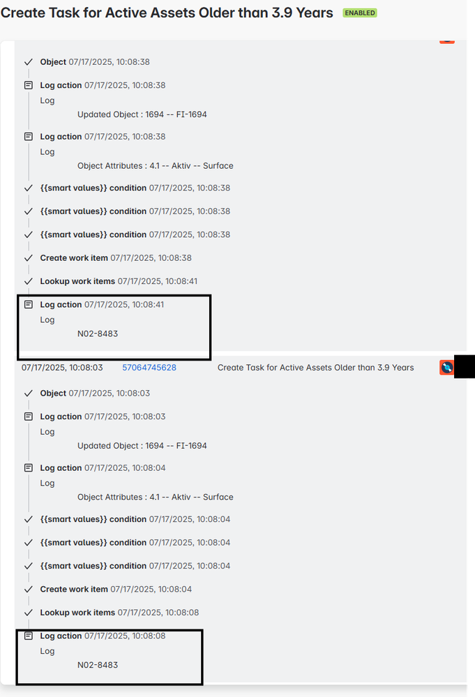

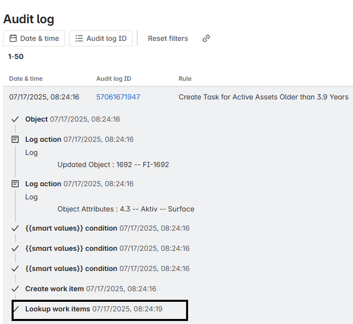

What does the log provide if you make a log action {{object.Hardware Device}}

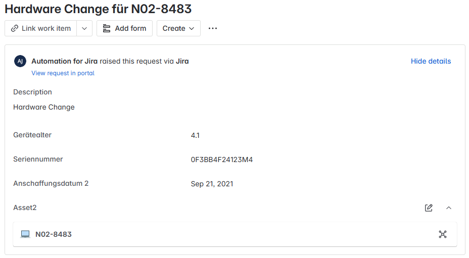

Other option on creating the new issue, can you set the asset field in the issue based on the object that is changing?
Then in the lookup you could JQL on: type = "Hardware Change" and <assets-customfield> = <object-set-in the-field>

Log:
So, the Asset Custom field is called "Asset2" :
type = "Hardware Change" AND asset2 = "{{object.Hardware Device}}"
Do you mean like that?
Object.hardware Device is the asset label
I tried it, but it doesn't work.

What does the log say on using "{{object.Hardware Device.label}}"

Now the rule doesn't work at all anymore, and I have no idea why. Not even when I undo the changes. There's nothing showing up in the logs either—only that I made some changes. But at least now you can see what kind of custom asset field it is. And that could also be used to identify the tickets

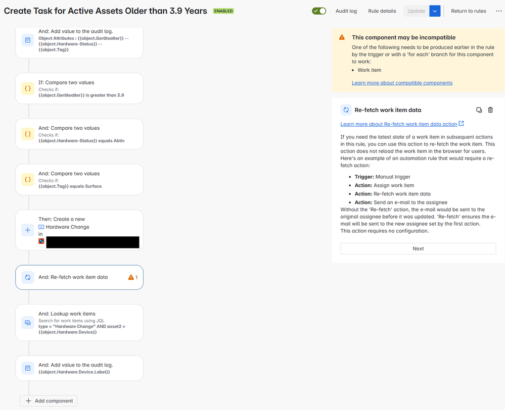

I think I was wrong on the smart label, I think it should be {{object.Hardware Device.Label}}
And add a Re-Fetch action after the creation of the new issue and before the lookup.
Antonia
July 17, 2025

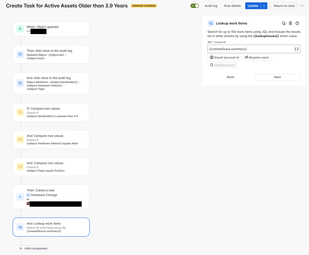

Log says:
Can't run component as it requires work item(s) in the context. More than likely you have a trigger that doesn't insert work items into the rule chain. e.g. Scheduled rule not running a JQL query. Creating a work item does not put a work item into the context, you have to branch on it to update it.
Marc - Devoteam
July 17, 2025
Hi @Antonia
Then use a branch, based on most recent created issue and do the lookup in the branch, also the log action for the time being

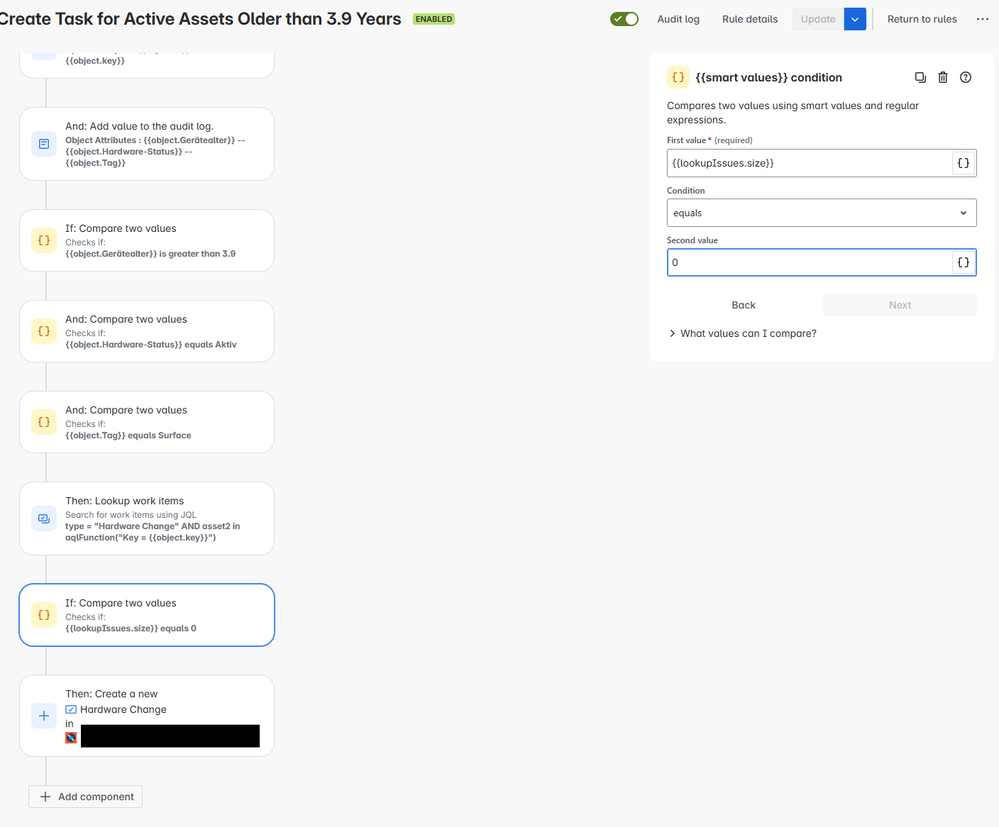

Antonia
July 17, 2025
I made it! I done it a bit different like you said, but it works:
I have moved the lookup function up one and then a smart value is added and only then is the ticket created.
Thank you @Marc - Devoteam for your help!
