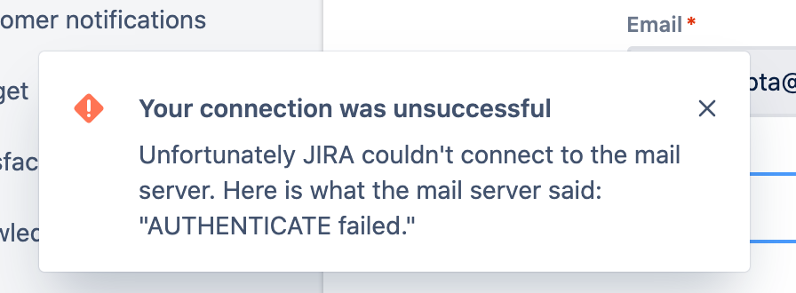

How can I successfully connect our custom email id to JIRA service desk? Connection Unsuccessful err
Project X
May 14, 2020
Every time I try that using "Connect a custom email account", I get the error "unfortunately jira couldn't connect to the mail server".
We user Microsoft with no MFA. We are using JIRA cloud hence no access to logs either.
Please help.

Hello Rajeev,
Thank you for sharing the screenshot and details.
Just for a better understanding of the issue, I would like to make some questions:
Which port are you using?
Have you tried both IMAP and POP protocol? If so, does it show any other error?
Please, make sure that IMAP/POP is enabled on Outlook side.
There are some cases where special characters on the password cause this issue. Can you change the password and remove any special character?
After that, please, try to connect the custom email again.

Hi @Angélica Luz  Thank you for responding. I am looking into IMAP / POP protocol. Regarding special character, Our workplace requires special character in the password. So, not sure if we can change that.
Project X
May 25, 2020
Hello @Angélica Luz , I checked with IT. We are doing IMAP on port 143. and IMAP 143 is enabled.
Project X
May 25, 2020
Also @Angélica Luz I tried with a new user account. Password has no special character. Yet, I am seeing the same error. PLEASE please help me!
Project X
May 25, 2020
@Angélica Luz thanks for your help! It finally worked. The problem was with special character.  But isn't removing special character from password makes it unsafe?
