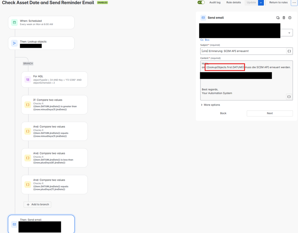

So I have built a rule that sends me a reminder email and the rule should contain the date on which I have to renew a key. The date is in the asset. I have also already built a query that also gives me a date in the mail, but the date is displayed the wrong way round and with the time. Can I change this somehow? I have already tried every formatting but none of them work.
{{lookupObjects.first.DATUM}} --> 2025-07-29T00:00:00.0+0000
??? --> 29.07.2025

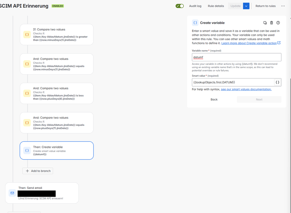

Hi @Marc - Devoteam
I tried it but no date will be put out.
I tried this in the mail too: {{<variable-name>.toDate.format("dd/MM/yyyy")}}, but it doesn't work.

Anything in done in an automation brach will not be usable in the main route of the automation rule.
Create the variable in the branch and the send email action asa well.
The send email action, now will only be able to use information found in the lookup action before the brach.
Anything that is done in the brach is not usable in in the sent email action.
A brach runs parallel to the main route of the rule.

So, I moved "And: Send email" into the branch and the "create variable" is above this action. But no e-mail is getting sent. When the Aciton "And: Send email" was not in the branch, emails were sent out.

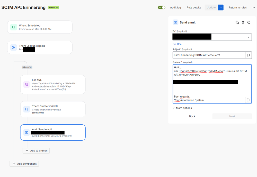

What if you place the variable creation and email action outside the branch?
Antonia
July 23, 2025
I changed the entire rule and only inserted a smart value in AQL and that was enough. and in the variable the smart value was enough: “{{object. ”Key expiration date“}}”, So thank you very much!

Where in the rule should I put the action with the variable?

I figured it out.
Variable: {{object."Key-Ablaufdatum"}}
Mail: {{datumf.toDate.format("dd.MM.yyyy")}}
