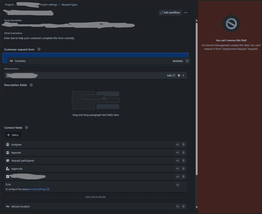

1. sounds obvious, but for the life of me I can't figure out how to do it. When I try to drag the summary field to the "hide" section, it's not possible:
I also can't rename the field.
I should probably mention I'm in a Team-managed project.

John Funk
April 5, 2024
Ah, yeah that is probably the problem that it is a Team-managed project. I would not recommend using those.

I ended up sticking with the team-managed projects, removed the field from the form, and left it in the customer-visible part of the request on the portal. I lose a bit of flexibility on formatting, but in principle things work.
