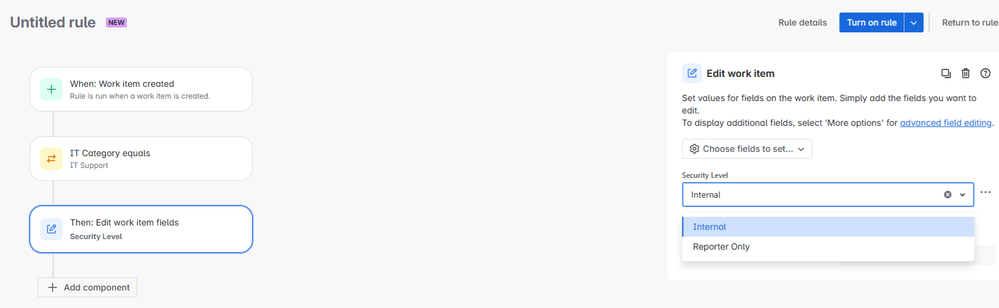

This is my rule:

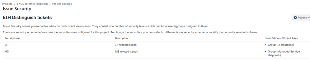

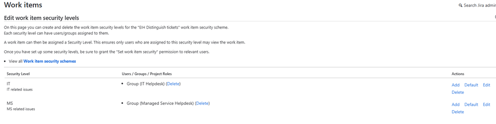

This is my security scheme with the security levels:
The main problem I have is when I try to create the rule, as you can see in the first pic, when trying to select Security Level, I get only those two options, I was expecting to see the security levels I had created in order to select one of the two and then create a second rule for the other security level.

As far as I can see, the project is company managed. I just connected the security scheme to the project:
And still, when I try to configure the rule, I see the same options:
