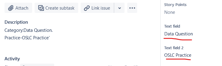

This looks like it should work - I've given it a go myself and have been able to successfully set the fields using the smart value:

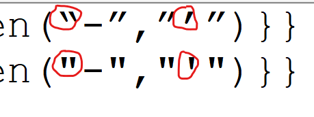

I copied and pasted both mine and your smart values into notepad to see if there were any small differences, and I did notice one:
For some reason, your speech marks and apostrophes are slightly slanted (no idea if this is just a strange formatting issue between devices/keyboards/languages) but this may be what's causing the problem - I tried copying and pasting yours into my automation rule and it did not work.

I got this to work. The issue was related to your original response Callum. I had to copy your smart values into notepad and then copy from there into my automation rule.
When I compared my original smart values with yours in notepad I saw something similar to what you saw:
Seems kinda weird, right?
