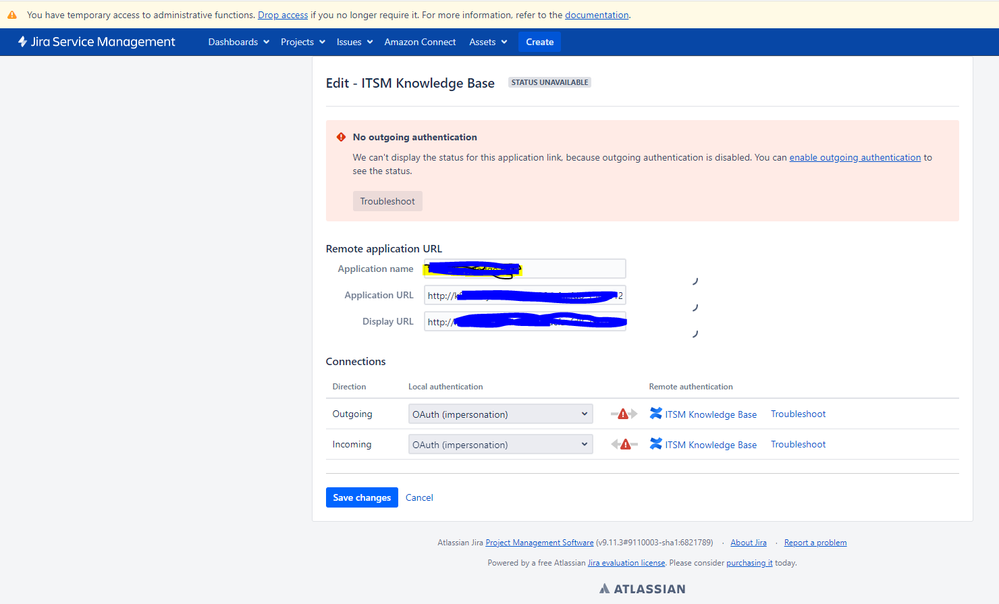

Hi Pro.
I has install JSM data center and Confluenec data center on aws cloud
I am facing an error in jira service management (JSM)  when I am creating Application Link with Confluence
error detail: "We can't enable the incoming authentication because ITSM Knowledge Base is not reachable."
How  can I fix error?

We already tried to config with "Oauth" without impersonation, but the error still the

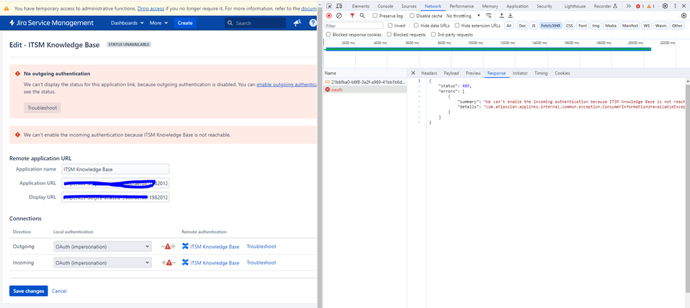

I am flowing your instructions. While I am trying setting and see networking send data
It has a error with detail
 Api : applinks/3.0/status/<token>/oauth
Request Method: PUT
response:
Status Code: 409 Conflict
"status": 409,
"errors": [ {
"summary": "We can't enable the incoming authentication because ITSM Knowledge Base is not reachable.",
"details":"com.atlassian.applinks.internal.common.exception.ConsumerInformationUnavailableException: We can't enable the incoming authentication because ITSM Knowledge Base is not reachable."
