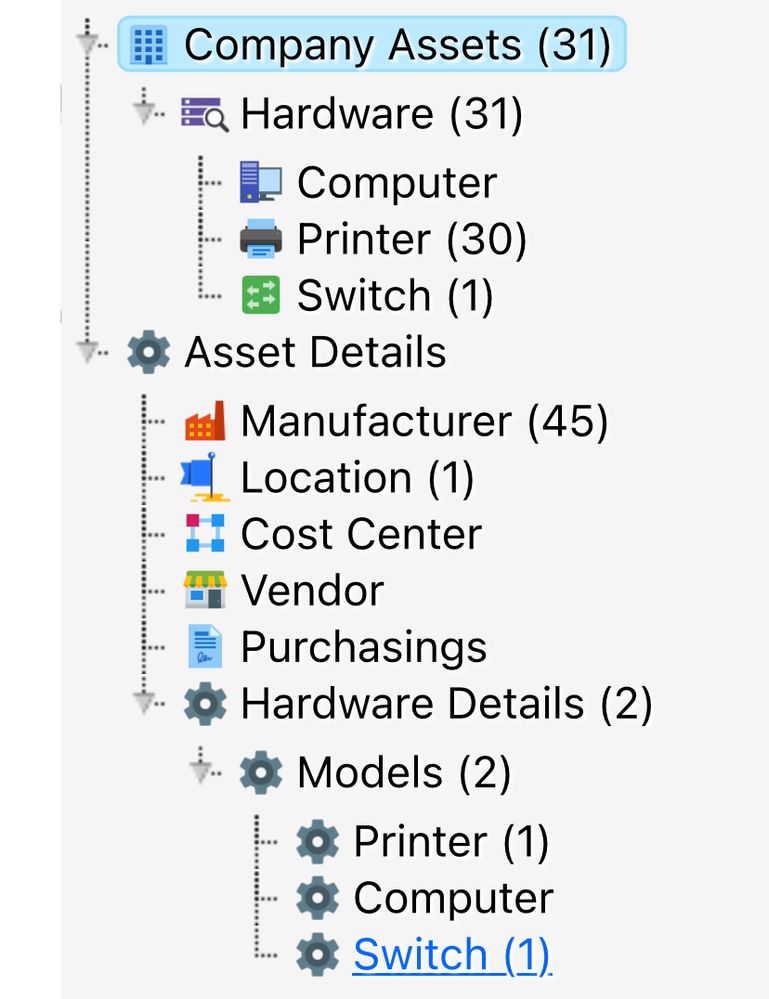

my current structure is looking like this:
if you are are also in the middle of structure and related logic, i would appreciate some 1:1 discussion about it. PN me via LinkedIn https://www.linkedin.com/in/frederic-wolf-026ab6239

@Frederic Wolf
Okay, this helps with the screenshot.  I wasn't sure how that was used but if I am understanding correctly, that specific statement refers to the objectType and any children under those objectTypes.  My model doesn't currently have any children associated.
Thank you very much!!!!
Frederic Wolf
August 8, 2022
Yep thats 100% like it works
