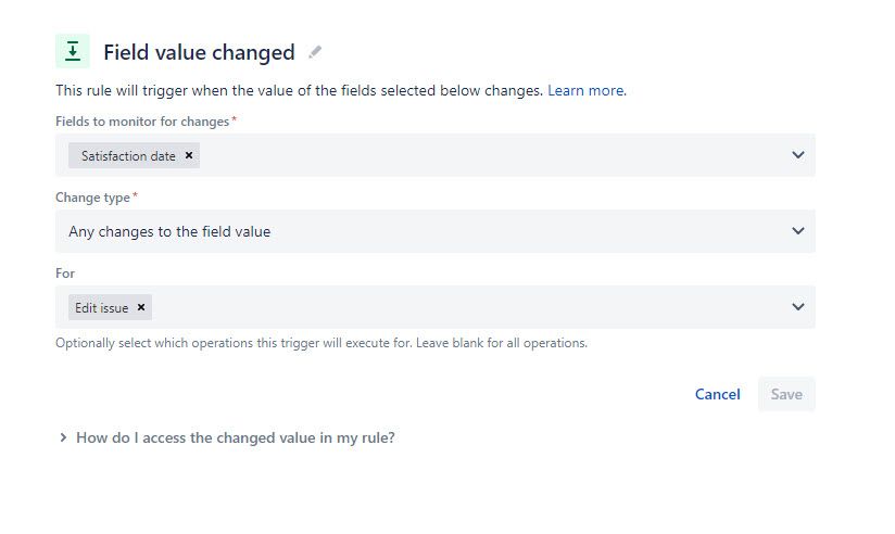

1. Create a custom field ‘CSAT comment’ and place it on the correct screen(s)
2. Create an automation rule in Automation for Jira:
3. Trigger: Field value changed: Satisfaction date (Note: don’t use ‘Satisfaction’)

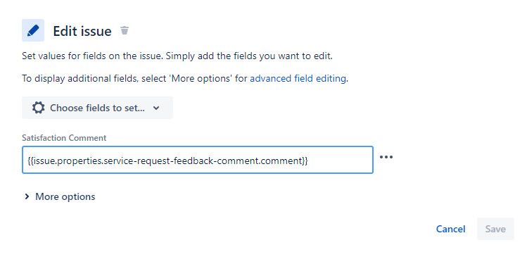

Also using Automation for jira, when your instance is in cloud you can use the smart value {{issue.properties.service-request-feedback-comment.comment}} without have to send a webrequest to the API, and directly edit the issue field.
Just tested, and this solution works in data center as well
Hi Luanna, can you share the automation details for using smart value you suggested?
Thanks
Brijesh
Thanks Luanna.
Brijesh, I created a custom simple text field (like Satisfaction comment) and added it to my service desk screens.
The automation uses a Field value change trigger basis when Satisfaction date is modified. Then it will Edit my custom field using the smart value.

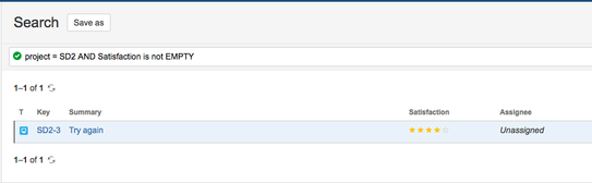

Satisfaction can be exported as to native "number" type fields with the Better Excel Exporter app.
In fact, the apps supports all the Service Desk specific custom field types, like Customer Request Type, Organizations, Request Participants, Satisfaction, SLA to Excel, and so on.

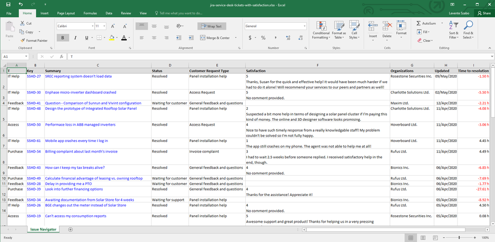

UPDATE ON 13 MAY 2020
We release Better Excel Exporter 5.3.0 just recently. Among other improvements, it can export customer satisfaction comment together with the numerical rating value!
Also, see column F in this example:

You can create a custom filter like project = SD AND Satisfaction > 0 . Add it on a Total cound or any other trend macro and then you can click on the total and export it fine.

I forgot to explain how to get the data into Excel (without buying an add-on) now that the "Export to Excel" option is gone and CSV is horrible. This is the state-of-the-art solution given by Atlassian, so we know it's approved.
BTW, the column you must include is a number field called "satisfaction", and that is the only field you get that has anything to do with customer satisfaction.
How to export data from Jira into Excel:
The Satisfaction column will have 5 stars in every cell, but the number of solid black stars is the actual satisfaction rating. Use Excel wizardry to turn those to numbers.

ok, I am now able to search for and find the information with this for all surveys this year. I receive a list of issues I can look through to read comments. However, when I export to excel, etc. I do not easily see the satisfaction comment information.
project = "XXXXXXX" AND Satisfaction is not EMPTY AND "Satisfaction Comment" is not EMPTY AND resolutiondate >= startOfYear() ORDER BY resolutiondate DESC
