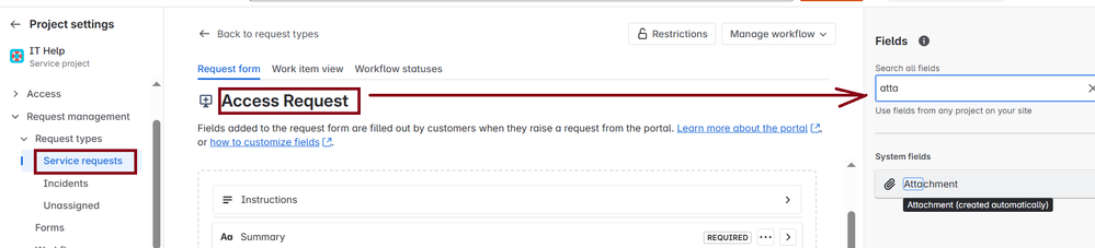

Go to your JSM project settings -->Request type --> Select the required group and the request from the list
Click on Request type where you need the attachment field and Attachment field to the form.
Attached screenshot for your reference.

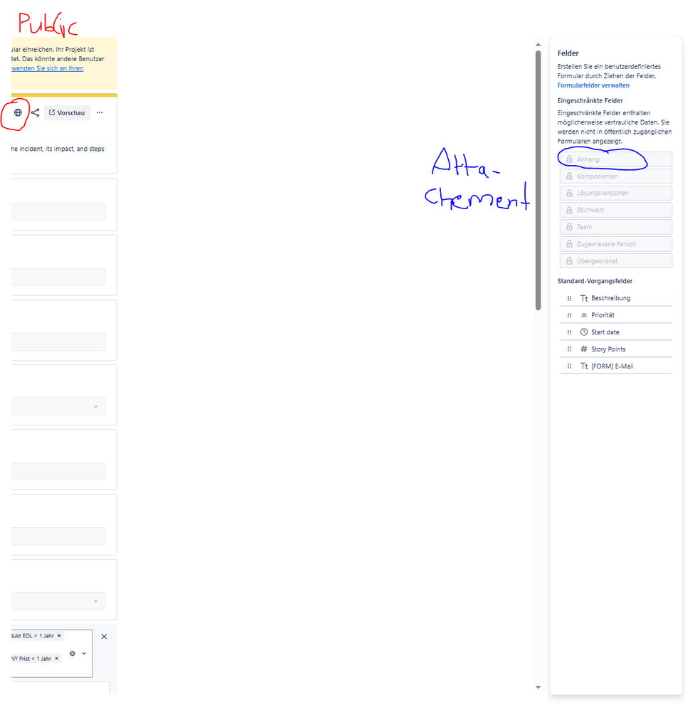

Nguyen_ Hieu Anh May 20, 2025
Did you just add the attachment field to the form? Because i cant find these settings and cant follow your solution.
I have already the attachment field on the right side in the jira form settings but i cant (drag and drop) into my jira form, because its only possible when the form is private. At the end i need a public form, so the attachment field is rn disabled.
Hi Marc,
its actually there on the form but if i set my form from private to public, the attachement field is disabled. (My Form must be public at the end)Jira_Bild.PNG
