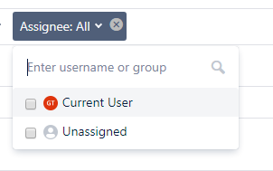

All the employees are added as agents and I can assign tickets on them.
I also tried the advance mode but result is the same.
Please check the attached image; this is what I see when I try to add assignee on a filter.
