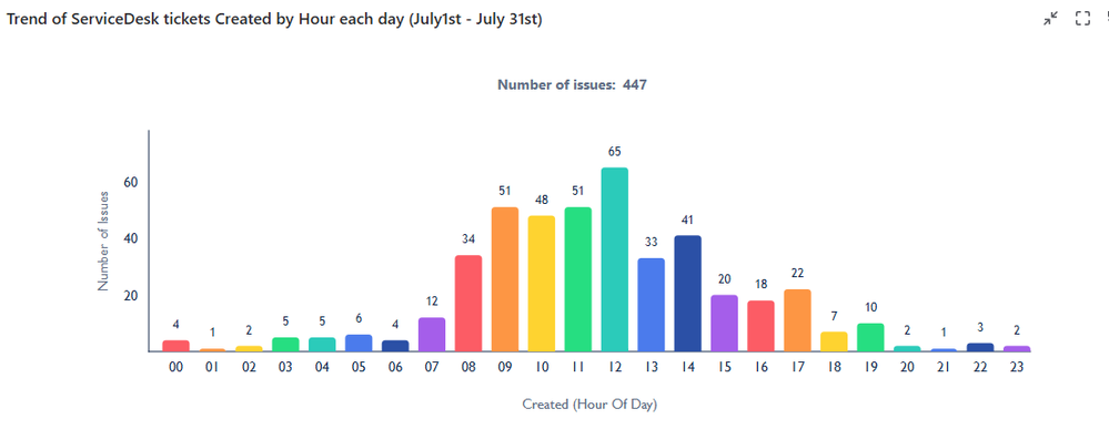

i know its a late post but i was able to get the exact same result as you are looking using the app Reports, Charts & Graphs (our org has the license) and it gave me the data like this
