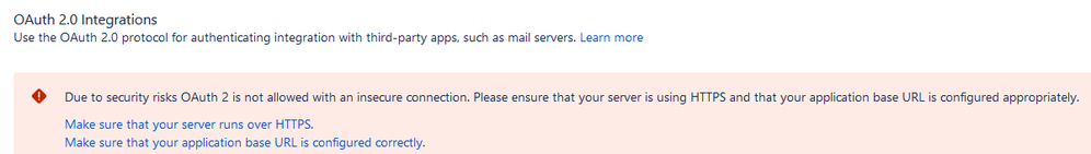

When I tried to set OAuth 2.0 as the authentication method in Incoming Mail settings I realized that it's not on the list:
Then I checked the OAuth 2.0 settings:
I'm not using HTTPS at the moment. Here Running Jira applications over SSL or HTTPS
in the documentation it is said:  If you need help with configuring SSL, create a question on the Atlassian community. So, I'd like to know how can I configure HTTPS in order to be able to enable the OAuth 2.0 authentication method?

Hi @JConstantine ,
Based on some of your other recent posts, I believe you're running Jira on Windows. This means you've got a few options available to you in order to run Jira over HTTPS:
In any case, it's expected that you've got a valid certificate signed by a public certificate authority in order to get HTTPS configured and OAuth working for email. If you don't have one already, you can get one free from Let'sEncrypt.

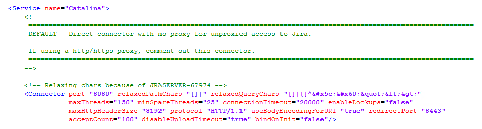

As I'm not proxying JIRA at the moment the following connector is set up in server.xml file:
FromServerXML.pngThere are connectors for proxying Jira via Apache and Nginx and they are commented at the moment. But there's no connector for IIS. According to the documentation I have to put this connector:

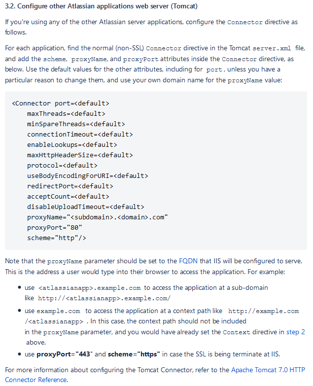

ConfigureIISConnector.pnginstead of the one that's currently set up in server.xml, right?
What do the following lines from the current configuration mean and do I need to put them into the new connector for IIS?
Relaxing chars because of JRASERVER-67974
relaxedPathChars="[]|" relaxedQueryChars="[]|{}^\`"<>"
use proxyPort="443" and scheme="https" in case the SSL is being terminate at IIS.
What does in case the SLL is being terminate at IIS mean?
Daniel Eads

  • If you're going to use IIS, then yes - you'll need to copy in a new connector as the IIS article mentions. The connectors for Apache / nginx that are already in the file can be uncommented if you're using one of those - which the setup guides for those will have you do
  • The relaxedPathChars prevents some characters that might be in a URL, like "&" from potentially breaking the proxy setup. Whichever guide you follow should specify if you need to do this for whichever proxy you're using.
  • Terminating SSL at IIS (or nginx) means that the proxy is where the certificate is installed, and that's where user's browsers would get the HTTPS connection from. In a simple diagram, you'd have:
    (user's computer)  <--HTTPS-->  (IIS)  <--HTTP-->  (Jira)
    When users interact via https://yourjira.whatever.com - it's IIS or nginx that is serving the site over HTTPS - or "terminating the SSL connection". The traffic between IIS and Jira doesn't use SSL/TLS in this scenario - it's regular unencrypted HTTP.

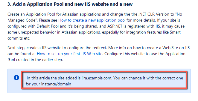

@Daniel Eads I've stumbled upon this:
2020-10-15_12-53-04.pngAnd there's this:
For me it's:
http://<JIRA Server Machine's IP address>.<JIRA Server Machine's domain name>:8080/

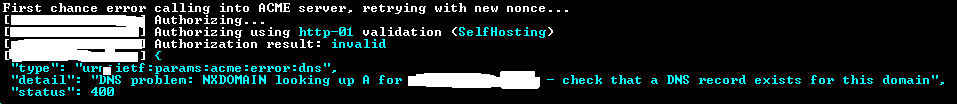

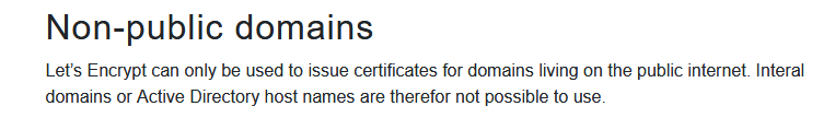

But whenever I try to procure a certificate from Let's Encrypt I end up with this error:
A and CNAME records for my domain name has been created. Port 80 for http and 443 for https are opened. Firewall has been temporarily disabled. Looks like I can't get the certificate from Let's Encrypt :(
