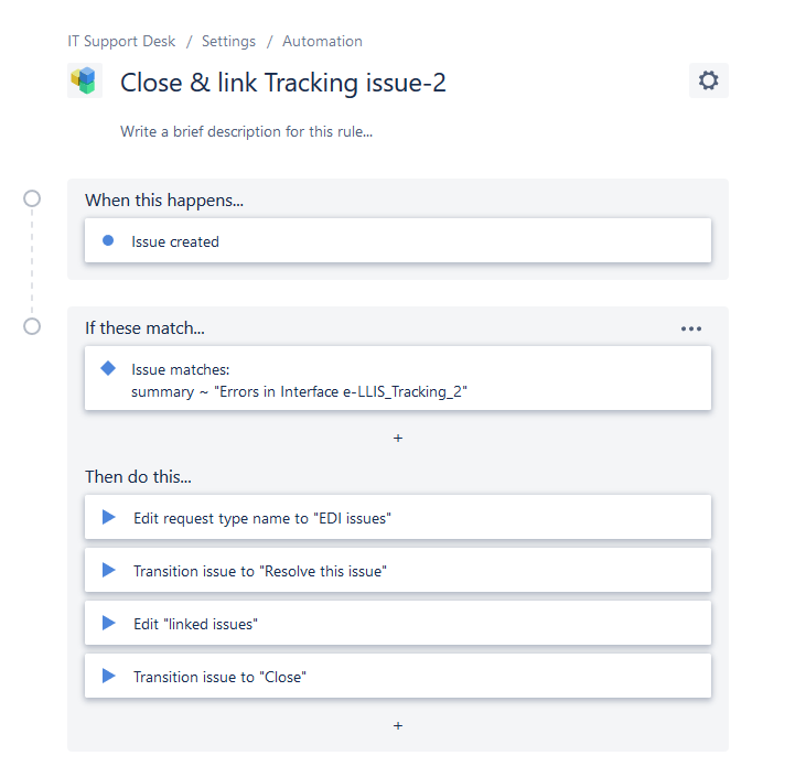

I have set up the automation as follows ;
When this happens ...
Issue created
If these match ....
Issue matches ...
summary ~ "Errors in interface e-LLIS_tracking_2"
Then do this ...
Edit issue
Field --> "linked issues"
Value --> ISD-19
Edit request type
EDI issues
Transition issue
issue transition --> Close
Everything is executed except that the Service Desk issue status is set to Close.
How can I close the status of this Service Deskt issue automatically with the trigger Issue Created?

Hello Angélica,
Thank you for your reply.
I think I solved the issue.
I have set the automation up like screenshot in attachment and now it seems to work.
Thanks for your help,
Peter
