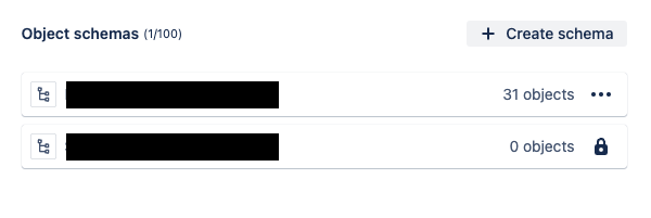

@Bea H You should be able to easily view your total number of assets from the "Object Schema Selection" Screen. This should list each schema you have, and the total number of objects each have.
You may need to move some of your items, such as your users, to a new schema in order to have these listed separately.
Here's how it should display when you click the "Assets" button in the top menu inside Jira.
