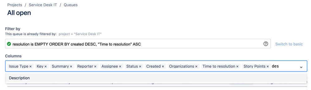

Hello @Courtney Watts,
On a Jira Service Management queue, it’s possible to edit the queues and add more fields. Go to All Open queue and click on … > Edit queue.
Then, under Columns, you can search for the field.
If you are facing issues adding the field, can you please let us know more details about this field? Was it created by you? If so, what is the type of the “Work description” custom field? Then, we can test here using the same options.

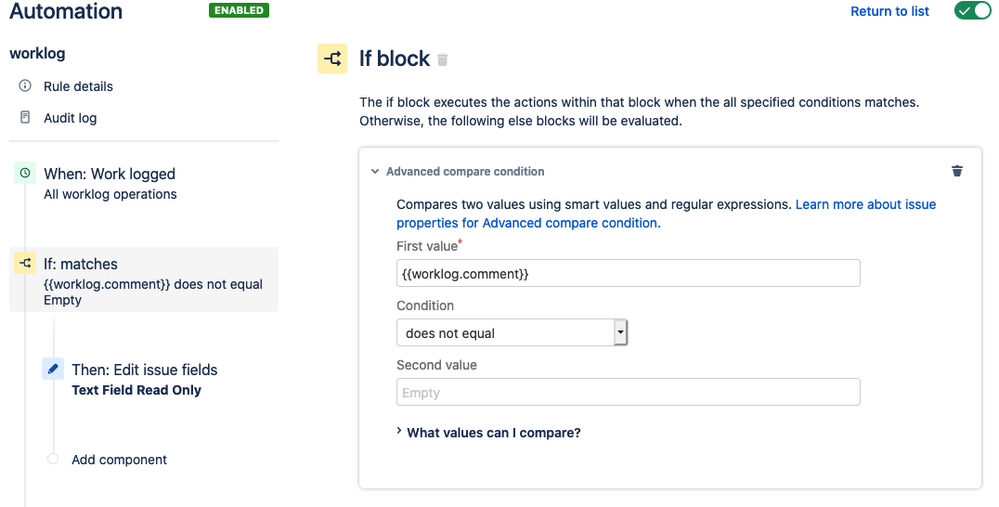

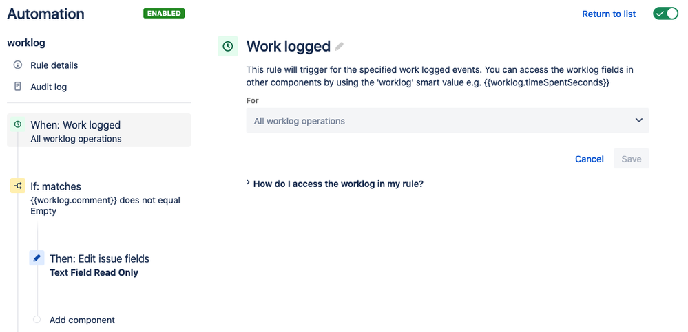

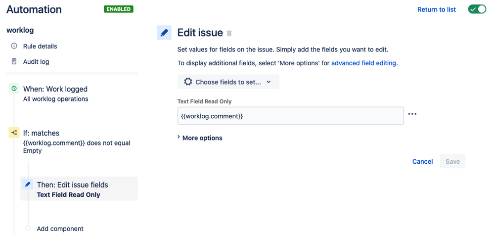

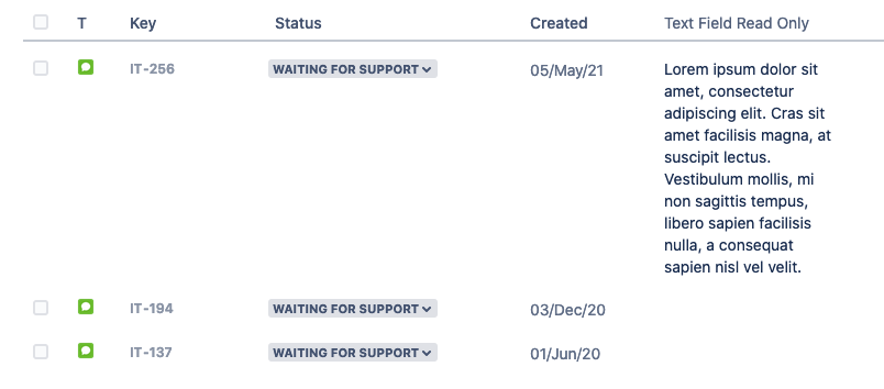

@Courtney Watts, if you need to add only the last comment of the Work description, I found a workaround that may help you.
First, you need to create a custom field, I tested here with “Text field (Read-only)” and then add the field to the necessary screens.
Also, go to the queue and add the new field you created.
After that, go to Project settings > Automation > Automation > Create rule. You can create like the one below:
Note that, every time someone adds a Work description, the previous value will be overwritten.

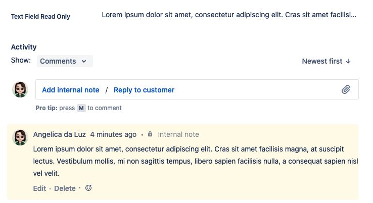

Courtney Watts
May 5, 2021
This was great and worked for the worklog information.
Would you know if it can be done the the latest Internal Note on the ticket and if so what the tag would be.
Thanks Again
Courtney
Angélica Luz
May 6, 2021

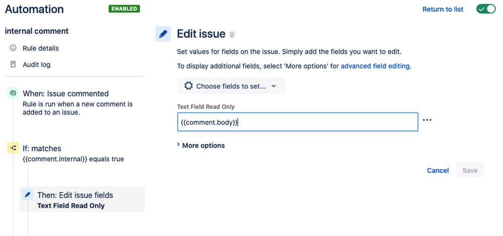

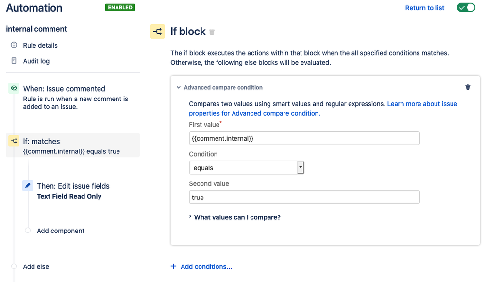

Hi @Courtney Watts,
It’s possible to use Automation for that as well.
The rule would be the one below:
When: Issue commented
If: matches - Advanced compare condition - {{comment.internal}} equals true
Then: Edit issue fields - {{comment.body}}
