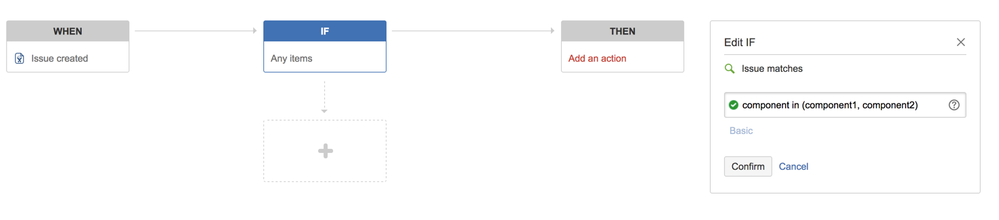

To accomplish this your rule should be created similar to the one below.
When - issue created
If - issue matches
Once you've set the If to "Issue Matches" then you should be prompted to input some JQL which I believe from there you can do something simliar to
component in ("component1", "component2")
Then - alert user
Hopefully that helps!Cheers!
Would it be possible to have an up-to-date answer, since the post was made back in 2017 (the image included is not present in the current JSM Cloud).
I'm desperately looking on notifying different team members based on the nature of the ticket.
@Eric Bergeron , I would suggest creating a new post. Your details might be different resulting in a different answer. FWIW the image is for Legacy automation which isn't in the more recent instances but remain in older instances (grandfathered).

yes i did but don't see a way to do that based upon component.
I believe that would show up in the 'IF' part of the rule
If - issue matches
Then - alert user
Ah...yes indeed it is there. I was sure it was there and completely missed the advanced link. That should do the trick.
