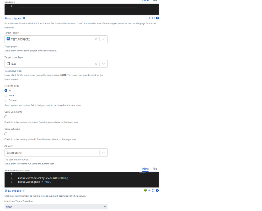

Hello everyone! Tell me please , i can how add security level in escalated issue ?
my code not works
issue.setSecurityLevelId(13080L)
issue.assignee = null

@Alex -
It seem your security level option ID is incorrect.  The option ID value doesn't ends with an alphabet.  Give a try just using 13080 instead of 13080L.
Furthermore, you need to ensure that 1) You have configured/applied an Issue Security Scheme against your project in question; 2) The account that is used to set the security level against an issue is valid and has right to set issue security permission (You can find the setup against your project's permission scheme.
Hope this helps.
