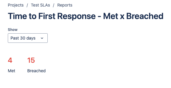

Hi, @Gizem Gökçe (OBSS) all SLAs were set prior to creating the issues. I created a new project to test this. What I see is that some apps have a "breached ongoing" category for SLAs in issues that are still open. And a "Breached" for the issues already closed. Anyway, Jira Report is only counting the Time to first response as breached if the issue is open, even if the SLA was set previous to the issue creation.
For example: jira report shows 15 breached for time to first response, but I have 17 issues breached for this SLA. But there are 2 that are closed already, since they met the time to resolution on time:
These 2 issues below marked in green are being counted in the breached count for the time to first response:
I believe using something like "breached" and "breached ongoing" seems a good idea, but I do not know how to retrieve this from the API. Does anyone have any idea?

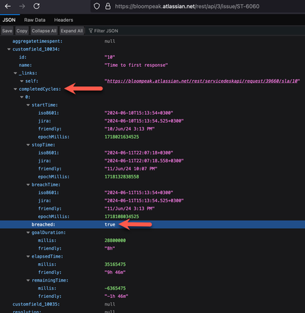

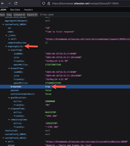

The information is available in Jira's issue rest api
YOUR-SUB-DOMAIN.atlassian.net/rest/api/3/issue/YOUR-ISSUE-KEY
In the response of Jira's issue rest api, the SLA fields have 2 sub attributes "completedCycles" and "ongoingCycle". Both of these attributes must be checked to detect breached issues.
Ongoing Cycle example:
Completed Cycle example:

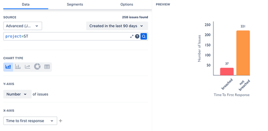

As an alternative, you can try Reports - Charts and Graphs for Jira app developed by our team. It checks both ongoing and completed cycles and generates the chart.
