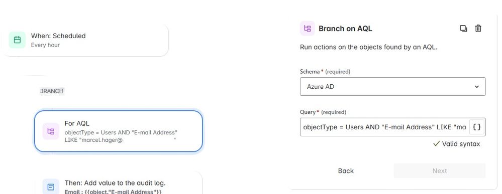

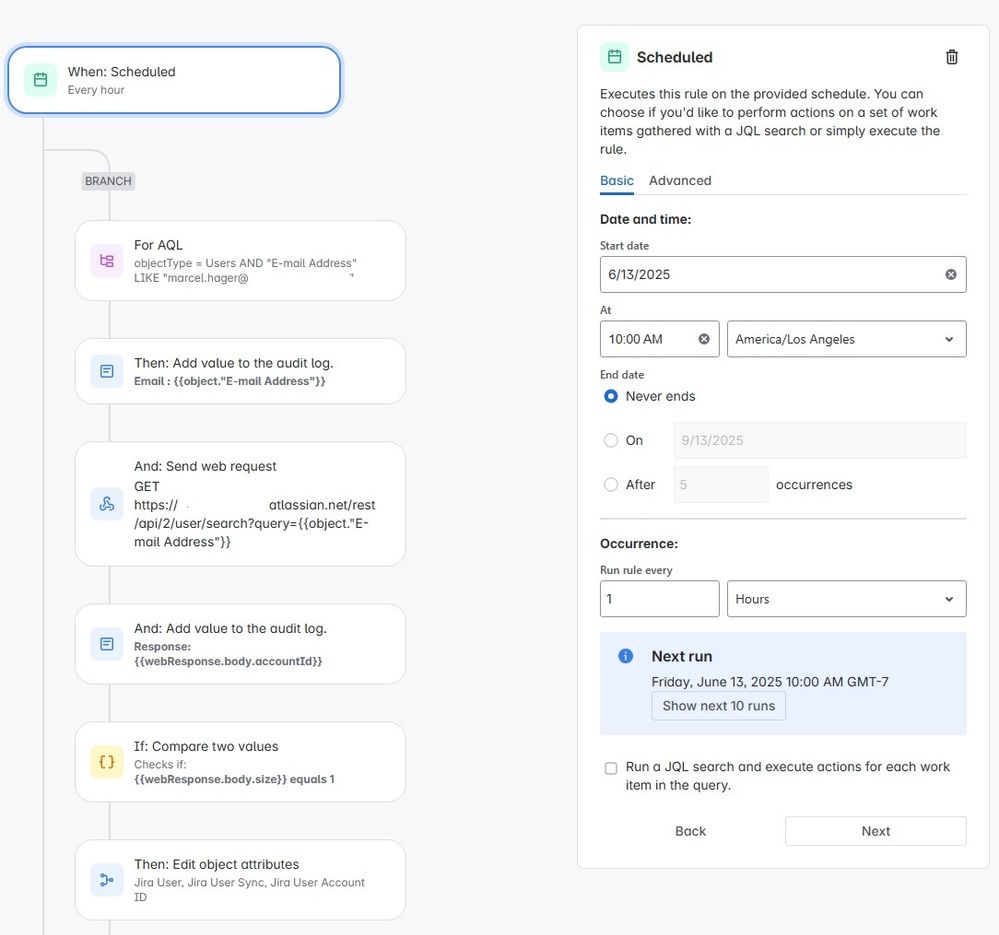

Step 1: Currently scheduled every hour but allows me to run on demand to test.
Step 2: AQL to find the object with a specific E-mail Address

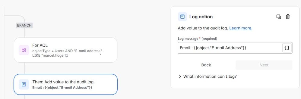

Step 3: Log the object E-mail Address so that I can confirm what is being passed into the web request

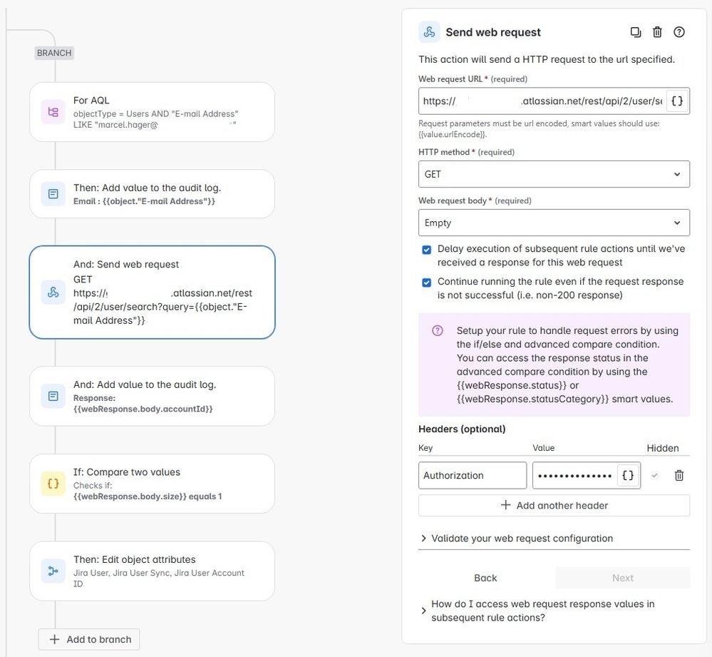

Step 4: Send the web request using the object."E-mail Address"

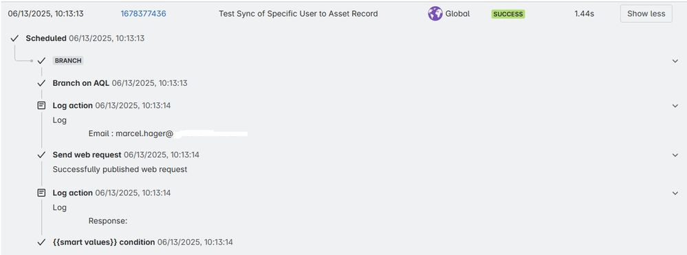

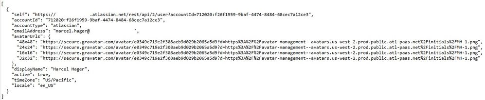

This is where things start to have issues, I think. If I plug the web request into a browser, it returns what I'm expecting:

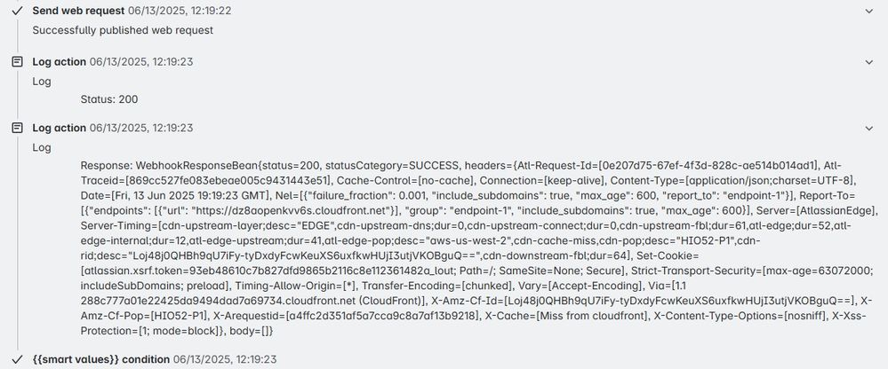

I try to log the webResponse to the audit log so I can see what is returned, but no matter what I've entered here I seem to get an empty response. I've tried using {{webResponse.body}}, {{webResponse.body.accountId}}, and just {{webResponse}}, and the only time anything shows in the logs is for {{webResponse}}.
Audit log:

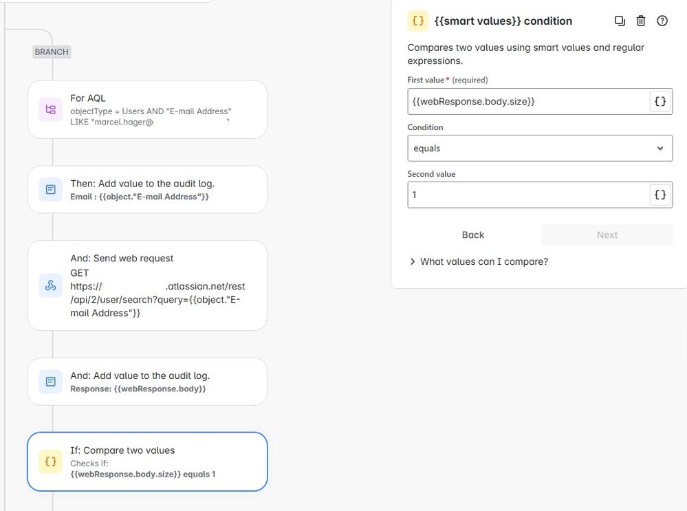

Step 6: Now if the web response would actually return properly, the comparison for the webResponse would happen here.

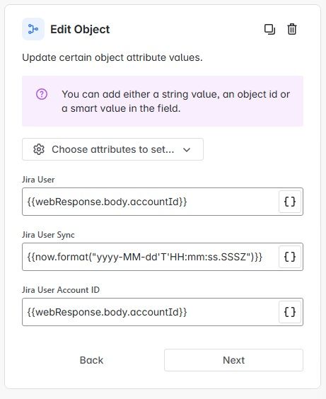

Step 7: This should be able to take the web response and parse it to find the values I need and use that to set fields on the asset, but this is not happening.

I notice your Send Web Request action has the option checked to keep processing even when not successful, but your rule does not check {{webResponse.status}} to confirm the call succeeded.  This may be why the log shows the response body is empty: the call did not succeed.
Next, I have observed timing problems with the Send Web Request action when smart values are used in the URL or custom data.  I have read other posts where this is worsened when the source is from an asset.  Perhaps try using a Created Variable to first build the URL and then use that fully evaluated one as the action's URL.

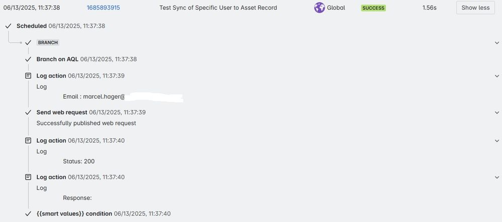

I added a logging step for the status, and it returns 200.

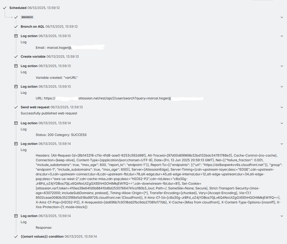

Thanks @Bill Sheboy for the ideas. So, what I think is happening based on the latest audit log is:
  1. AQL queries an object with a specific email address (my own)
  2. Value for {{object."E-mail Address"}} is logged and is the expected value
  3. Then the variable {{varURL}} is created with the web address that resolves when used in a browser
  4. The {{varURL}} variable is logged and does appear to be correctly formed as expected
  5. Web request is sent with {{varURL}} as the web request URL. This step is also set to delay execution until the response from the request is received
  6. {{webResponse.status}} is logged and shows 200, so should be successful
  7. {{webResponse.headers}} are returned
  8. {{webResponse.body}} returns nothing in the logs
  9. Automation stops here because the comparison step for {{webResponse.body.size}} won't be equal to 1 (I think)
I've tried also adding delays between steps, but the result is the same each time.

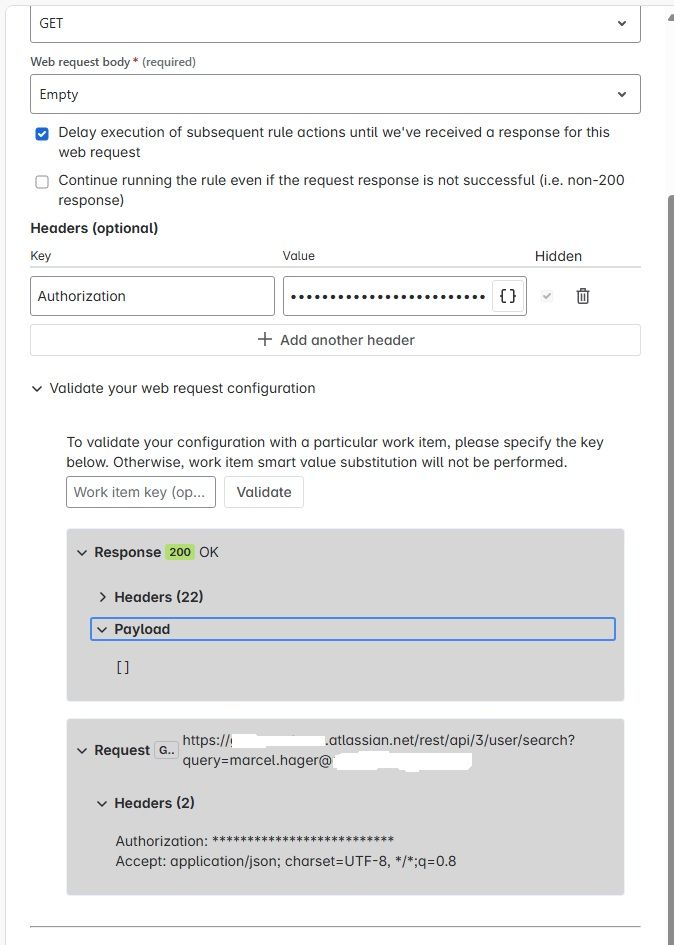

  • at the bottom of the action, select "Validate your web request configuration"
  • select "Validate" to run it
  • this will check if the headers / token you are using will indeed return the expected results in the response
  • when done testing, delete that copy of the Send Web Request action
Also, I just noted you are using version 2 of the endpoint rather than the latest version 3.  Perhaps try changing to that version:
https://developer.atlassian.com/cloud/jira/platform/rest/v3/api-group-user-search/#api-rest-api-3-user-search-get
Marcel Hager
June 13, 2025
I've updated to API version 3 as well, but the same result is returned. Even when hardcoded with my email address the webResponse body is an empty array.
I validated the configuration and got the following results:

This seems to indicate an authorization / access problem:
You earlier tested with a browser (which uses your Jira credentials when logged-in) and received the record, but when hardcoding a URL in the rule there was no result.
Please confirm, or regenerate your API token, for a user with access, re-enter it in the action, and re-test.
