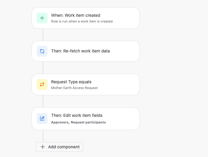

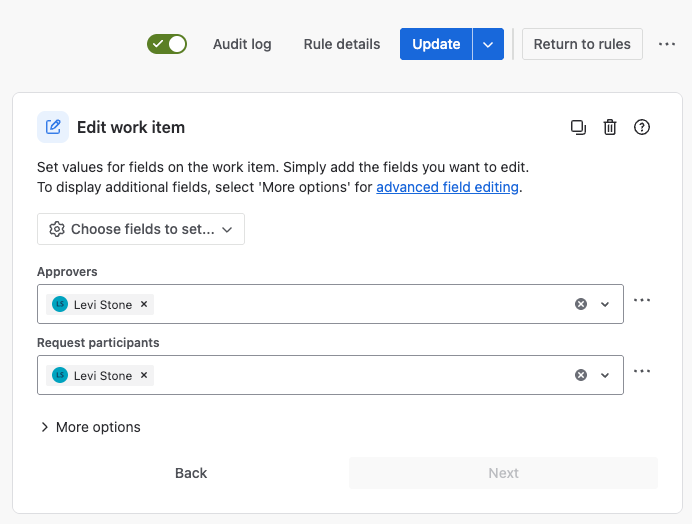

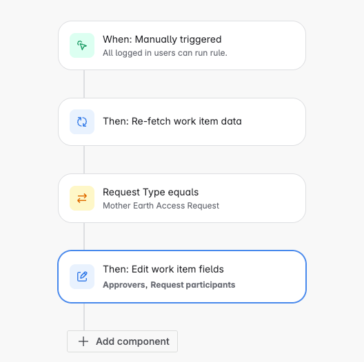

Levi Stone
July 8, 2025
Screenshot 2025-07-08 at 3.00.48 PM.pngScreenshot 2025-07-08 at 3.02.17 PM.png

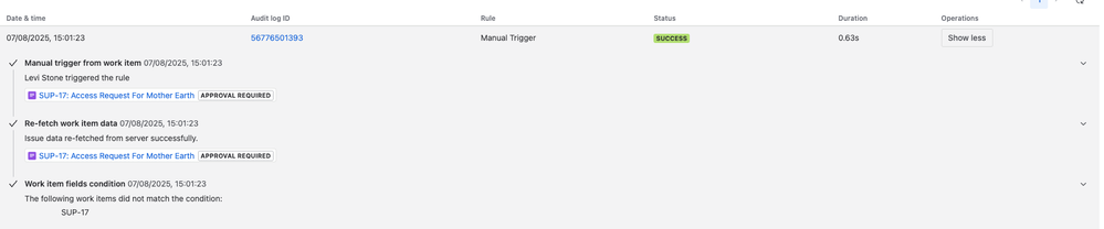

Bill Sheboy
July 8, 2025
Your original question indicated the trigger was Work Item Created, and that is why I suggested adding the re-fetch action.
Now your rule is using a Manual Trigger.  Did you change the trigger for testing purposes?
The audit log shows that work item, SUP-17, does not match the Request Type of "Mother Earth Access Request".  What value is currently selected for the field?

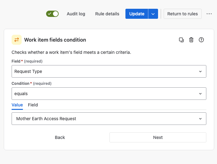

Levi Stone
July 8, 2025
@Bill Sheboy my apologies I uploaded the wrong picture.  I had a manual one for testing and it fails the same way.  Here is the none manual trigger one.  Screenshot 2025-07-08 at 3.37.08 PM.pngScreenshot 2025-07-08 at 3.37.17 PM.pngScreenshot 2025-07-08 at 3.35.53 PM.png

Bill Sheboy
July 8, 2025
I tried this with a rule in a JSM project and the field condition with Request Type worked as expected.
Do you perhaps have multiple request types with similar names and the wrong one is being checked for a match?
