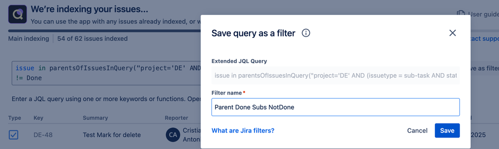

Hello @Mathew Lederman ,
I'm Cristiano, with the Appfire team here,
if your only concern is to build filter, then the app our team works, JQL Search Extensions, will still help with that.
First the queries:
1.
issues in parentsOfIssuesInQuery("project='Wano' AND (issuetype = sub-task AND status = Done )") AND status != "Done"
2.
issue in subtasksOfParentsInQuery("Project='Wano' AND status='Done'") and status!='Done'
The main difference from native Jira is that these queries, from within the JQLSE app are dynamic. And as I said before, after searching from within the app, you are able to save the custom query as a filter and use it elsewhere with the:
filter=<filter name>
Feel free to contact our support team if you need help setting this up, or any further question about the app.
