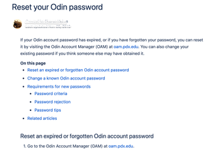

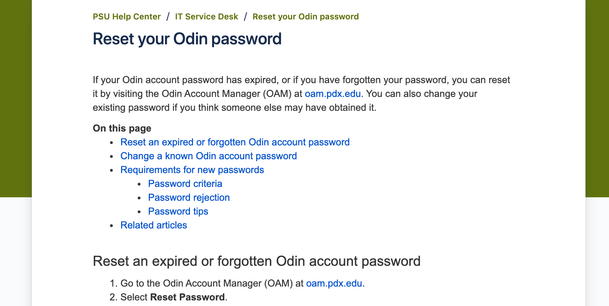

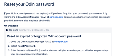

Here are some screenshots showing how it works for us:
This first image shows the TOC-zone macro in Edit mode. The main body/text of the page is inside of the macro. We set it to show headings 2 and above, only at the top.
This next image shows the page published in Confluence, with the TOC generated underneath the words "On this page".
This last image shows the same page viewed from our connected Jira Service Desk Help Center. The TOC links successfully work to let the viewer skip down the page.
I hope this helps! Best wishes, Sharon
