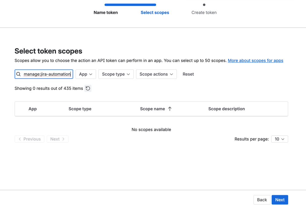

could you please advise where would i locate manage:jira-automation. when i select granular scopes, i couldn't find this particular scope at all.
appreciate your assistance. thanks

Hi @Wills Seet ,
1) I apologize for the mix-up—it's actually named "manage:jira-configuration" This granular scope allows CRUD on automation rules without over-privileging. (Reference: Jira scope for OAuth 2.0 / API token scope from Jira REST API).
Where to find it:
  • Atlassian Account > Security > Create API token > Granular scopes.
  • Search: Type "manage:jira-configuration" (or just "configuration"—it auto-suggests).
    • If nothing: Filter by App = Jira Settings (not "Jira Software" or "Automation") > Scope type = "manage" > Actions = "Manage Jira global settings."
  • Select it > Create token. (Your screenshot shows 0 results because the search might need the full phrase or category filter—try "jira-configuration" without "manage:".)
  • Note: If still missing, fall back to the classic scope "write:jira-config" (covers config writes, including rules). Test with a minimal token first :)

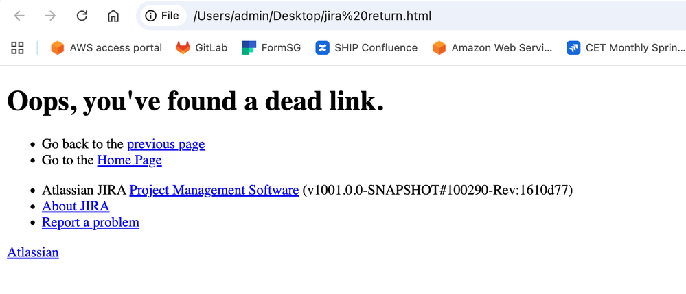

i created a new api token with just manage:jira-configuration scope and used the url format you suggested without {cloudid} but getting the following 404 html response back. i saved the html and render it based on the screenshot below.

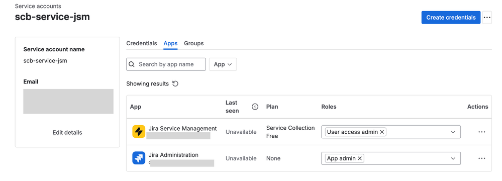

also how do you verify that the service account has Jira admin perms. please see the 2nd screenshot below.

Peter_DevSamurai
Atlassian Partner
October 26, 2025
Hi @Wills Seet ,
The first one (404 "dead link" page) looks like a standard Atlassian "oops" for an invalid URL, but it's actually the service account management view (not the API response itself—API 404s usually return JSON like {"errorMessages":["No such rule"]}).
The second confirms your service account setup. The 404 likely stems from the endpoint path (Automation is under /automation/latest/, not a JSM-specific one) or the service account lacking project access for rules. "manage:jira-configuration" is correct for scopes, but the account needs Jira admin for rule ops.

2) Verify Admin permission
  • Log in as a site/org admin (not the service account) > Go to Settings (gear icon) > User management > Users.
  • Search for the service account email > Click it > Under Permissions, check if "Jira administrators" or "Jira system administrators" is listed (or if it's in the jira-administrators group via Groups tab). (Refer to this similar post)
  • To add: Edit user > Add to jira-administrators group (global perm for rule management).
    • API Check (if you have a working token): GET /rest/api/3/mypermissions—look for "havePermission": true under ADMINISTER (global). (Refer: Manage global permission)
Note: The "dead link" screenshot is just the service accounts UI (scb-service-jsm) so it's not the API output :)
