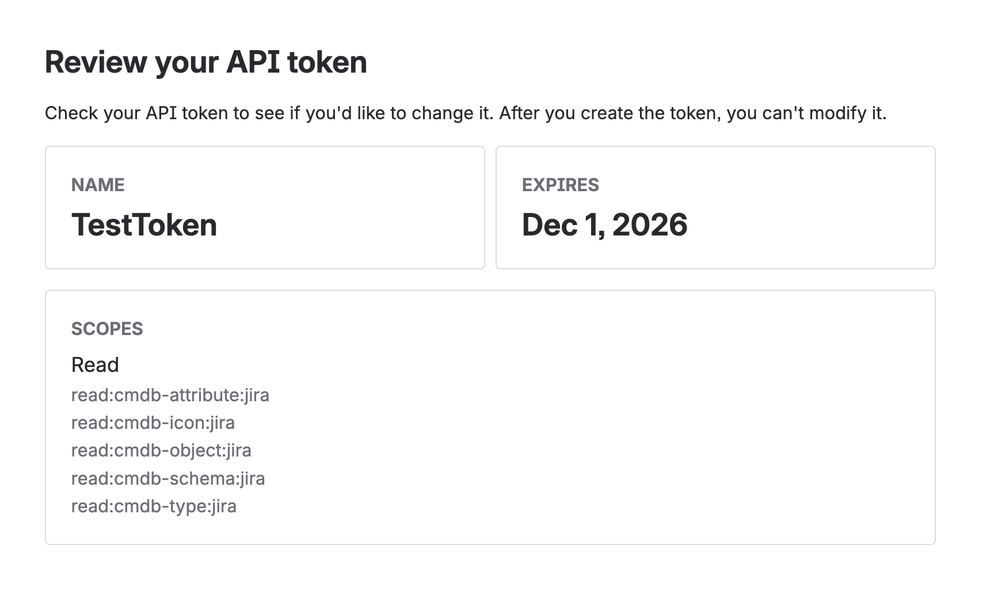

3. I added all cmdb read scopes:

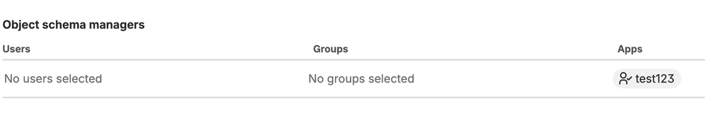

7. Went back to the schema and added the service account under Apps within the schema I want it to be able to access as an Object Schema Manager:

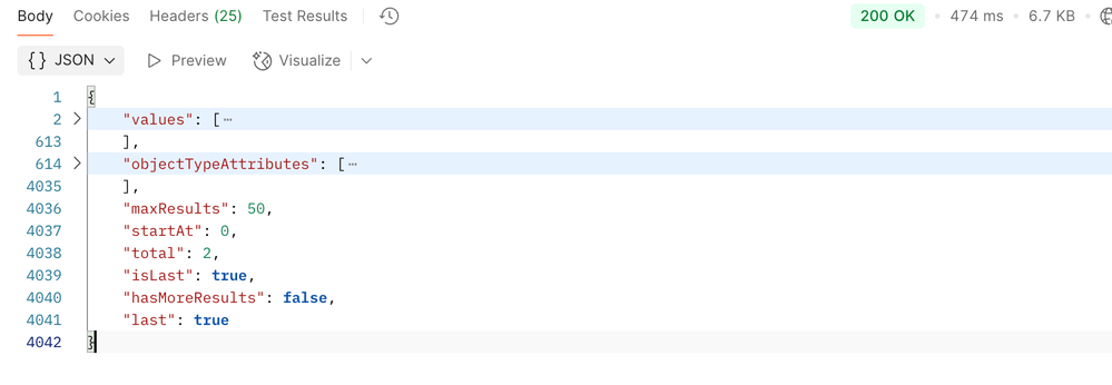

8. Ran it without any issues:
My guess is yours doesn't work because by default the includeAttributes query parameter is true, and if you don't have the scope to read that, it would fail.
