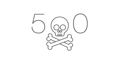

At several occasions in my workflows I use ScriptRunner (groovy) scripts to clone issues and link them automatically. That works fine, but now one of those scripts lost a certain preference and created a broken clone that is not accessible. If I enter the URL for that issue I get a:
