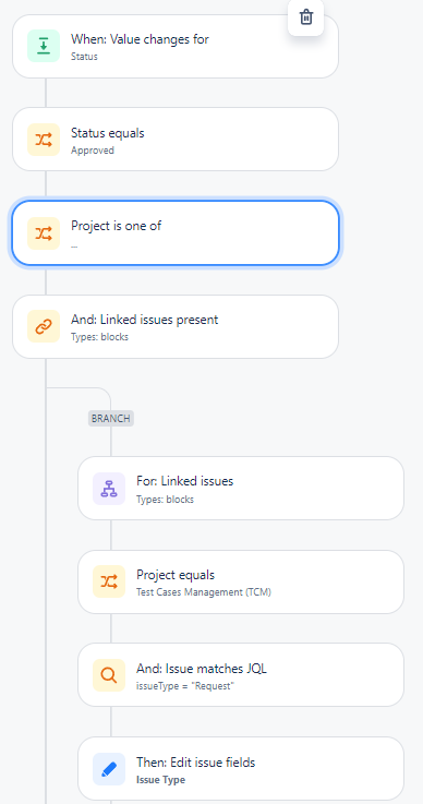

Hi,
I am creating a "Global automation" in which my trigger is triggered when there is a change to the issue's status, this status must be equal to "Approved" and these issues must belong to project X, Y and Z. In each issue must still be present issue links of type "Blocks". Then, for each issue, it must belong to the "TCM" project and the issueType = "Request", then the status of each issue will change from "Request" to "Implement". The entire process works correctly, until the change of issueType where the error "The issue type selected is invalid. (issuetype)" appears.
Below is a screenshot of the automation.
Notes: We added the issueType "Implement" to the default issues Type, we also tested adding it to the issueType of the "TCM" project itself, but without success.
Can you help me in this regard?

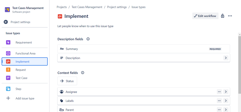

Can you share the screen shot of the issue type scheme in the TCM project
Project settings > issues > Types
Cláudia Silva
May 13, 2024
Yes of course. These are the issue types that were created for this project and one of them is "Implement". Even so, we also created an "Implement" in the default issue Types but neither one nor the other identifies it.

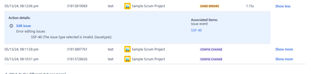

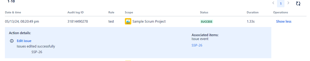

Hi @Cláudia Silva
I tired to recreate the issue and I also got the same error at first then I decided to check with another issue type which worked and then again I tired the issue type which gave me the error and this time it didn't show me the other  it changed
For testing can you try whether the automation is working with another issue type. try to change the last action issue type to another issue type instead of "Implement"
Cláudia Silva
May 13, 2024
I tested changing the issue type to "Task", which is also a default, and then I tested it to "Request" and neither of them worked, it still gives the same error "The issue type selected is invalid. (issuetype)".
A curiosity is that in the previous step it is a JQL condition in which I say that the issues found must be of the "Request" type and then it has no problem identifying the issue, but then in the then it no longer accepts because these issue types They are the default ones and it seems to me that it does not identify that this issue type also has to belong to the TCM project.

As we see the issue types in the TCM project you don't have a issue type "task" In the TCM project you have only "Requirement" "functional Area" "implement" "request" "test case" and "step" you have only these issue types

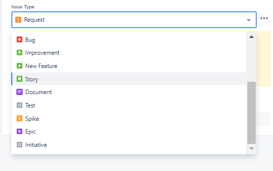

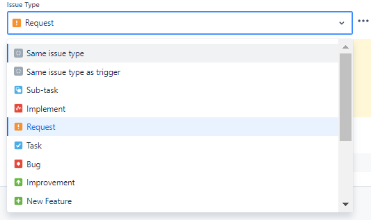

can you check whether in the action dropdown you getting two issues types named implement
Cláudia Silva
May 13, 2024

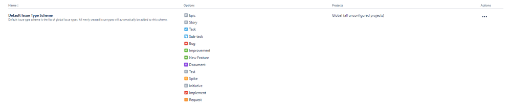

In the dropdown you have all the options that exist in the "Default Issue Type Scheme". And no, there isn't the issue Type "Implement" twice...

Is TCM is one of the project you selected in the first condition (these issues must belong to project X, Y and Z.)
Jerrold - Empyra
May 13, 2024
and can you also check the rule details scope what all projects its showing
Cláudia Silva
May 13, 2024
No.. In the first condition there are 3 other projects, only after searching for the linked issues do these have to belong to the "TCM" project.

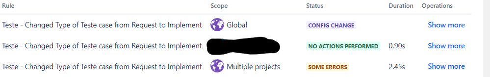

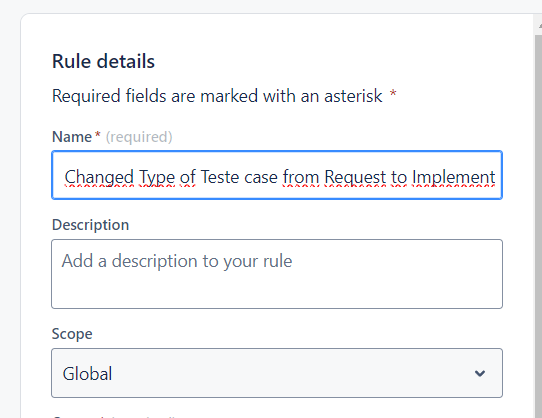

Cláudia Silva
May 13, 2024
In rule details I have Global but in the audit logs when it gives the answer, it changes to Multiple Projects.. I don't know if it's the normal process..
Jerrold - Empyra
May 13, 2024
This may help change the scope in the rule details to only TCM project update it and then go to the last action and now in the drop down you should only see these issue types
In this you select the Implement and update the automation and then again go to the rule details and change the scope to global then run the automation
Cláudia Silva
May 13, 2024
It worked @Jerrold - Empyra !  Out of curiosity, is there any logic to this? Thank you very much for your help and quick response.
