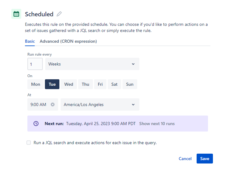

Hi @Stefan Speck, I would recommend setting up the following:
Trigger:
  • Use the Scheduled trigger, and set this to run at a particular time every day (I'd suggest a time towards the start of the working day)
  • Tick the 'Run a JQL search and execute actions for each issue in the query.' checkbox and enter a JQL of status in (canceled, done) and status changed to (canceled, done) before "-1w"
    • This finds all issues that are currently in one of those two statuses, and have transitioned to them over a week ago
Actions:
  • Use the Transition Issues action, and select the Closed status
You could also add some conditions between the trigger and the action in order to restrict the rule down to a particular set of issues.

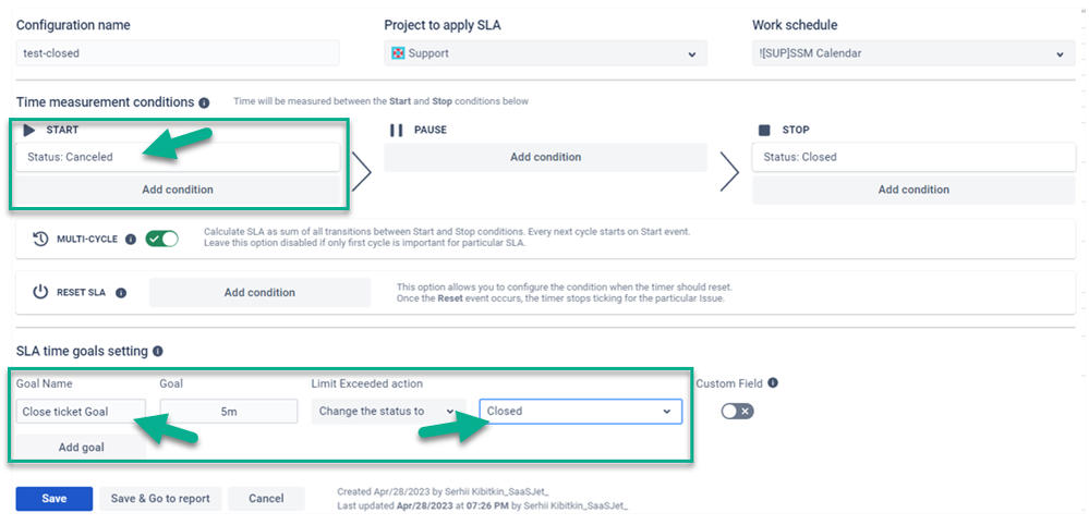

Hi @Stefan Speck
As a simple alternative, you can try the SLA Time and Report for Jira add-on (developed by my team).
For the Start condition, set the one Status you want to change, and for the Stop, set the Status you which will replace the previous one.
To the SLA time goal, set the trigger in 5 minutes and select the action "Change the Status to " the Same Status as for the Stop condition.
That's all. It should work. You can add conditions, such as issue type, to make the automation work for a more specific list of tasks.
Take a 30-day trial to see how it works for you.
