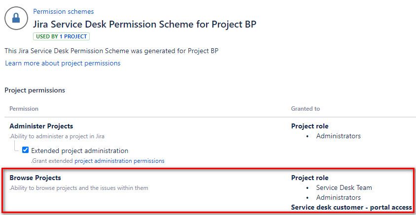

Permission scheme of what project?
there are many permission schemes for many projects, for example, I send one of them:

You need to update all relevant permission schemes by adding this group “jira-administrator” to browse projects permission

You can't "add jira-administrator" to all your schemes in bulk , you should do it one by one and it is recommended to have redesign your permission scheme where you can use shared one with different project roles upon your needs administrator is a project role where you need to grant the desired permission inside the permission scheme , don't get confused with the name
