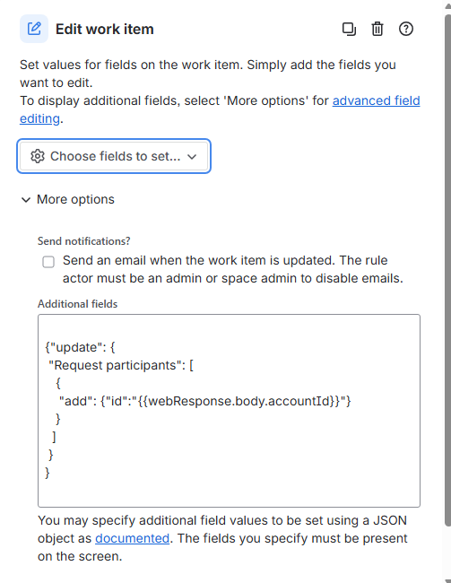

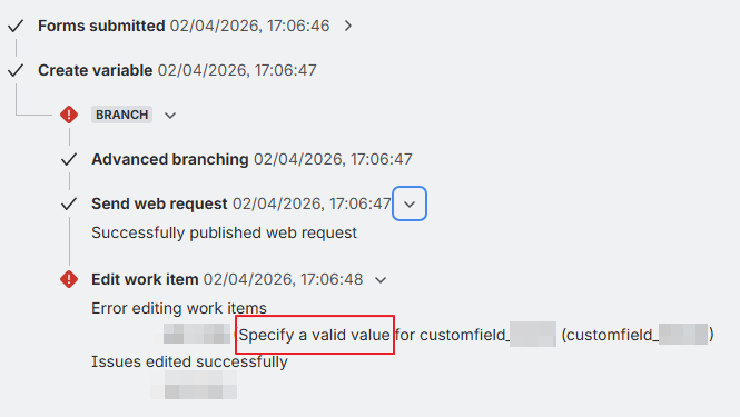

but the account ID seems can't be added. could you please help check if my next action/edit work item is correct(actually i copy from Manage Request Participants with Automation in JSM Cloud | Jira and Jira Service Management | Atlassian Support)?

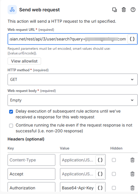

P3: "Send web request"
P4: "edit work item"
P5: "audit logs"
Hi, i think you have to use
{{webResponse.body.first.accountId}}
to get the accountId from the response from the api., because you get an array back.
BR
Kai
Hi @Vina Wu

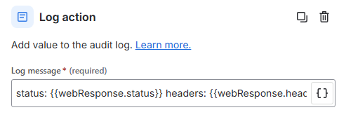

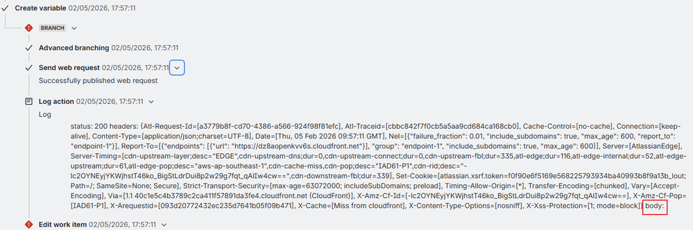

What is the response of the web request.
Can you log this, as it seems there is no valid response.
What if you make the request in a browser window, using the URL and the mail address provided in the field.
Is you variable in the branch also set to {{EMAIL}}, naming needs to be correct in the web request on the variable name from the branch action.

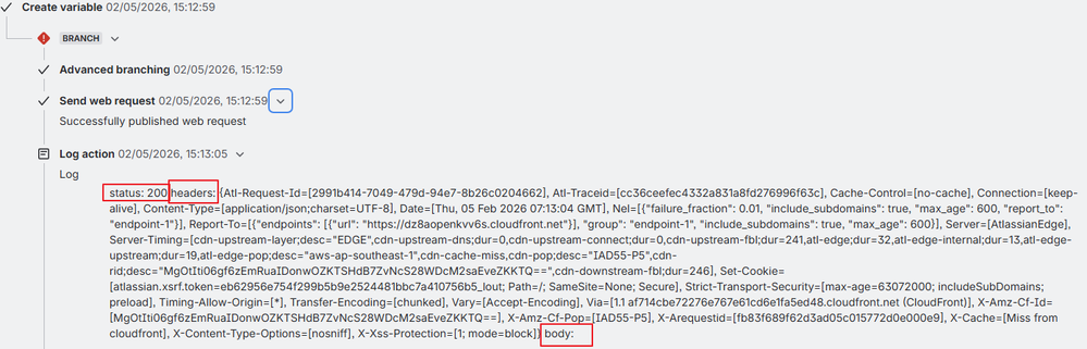

Hi @Marc -Devoteam- thanks for the suggestions.

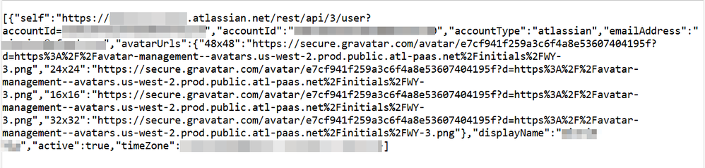

I tested the URL with actual email in both JSM and browser. and found that JSM responded blank and browser could response account id. Could you please advise again? thanks.
rule and log in JSM:
response from browser:

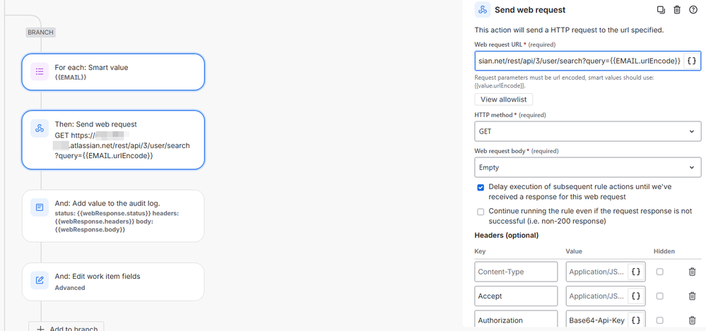

Hi @Vina Wu

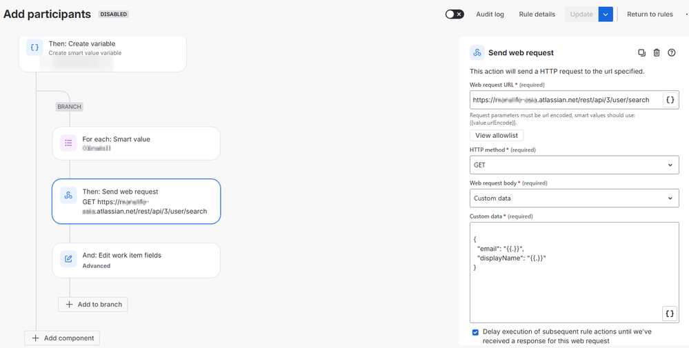

What is the configuration in your branch action in the automation rule?
You are creating a smart value there {{smartvalue}}, you need to use this smart value in the API call (mind capitals).
What is the full url for the API call? (you can hide your domain part)
Hi @Marc -Devoteam- thanks.
please see the detail Branch rule as blow. and new logs for this rule.
URL is :https://xxxxxxxx.atlassian.net/rest/api/3/user/search?query=vinaxxxxx.com

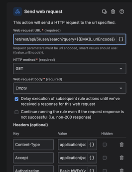

Hi @Vina Wu
Change authorization value:
to Basic and your key, als add key Content-Type and values Application/JSON, also for Accept.
The greyed out options are not taken.
See my screenshot.
There is something wrong in your web request details, as the browser provides feedback correctly

Hi,
i think
you have to call
https://<yoururl>.atlassian.net/rest/api/3/user/search?query={{EMAIL.urlEncode}}
with empty body as get and in the headers Authorization with a Basic < Base64-Api-Key
