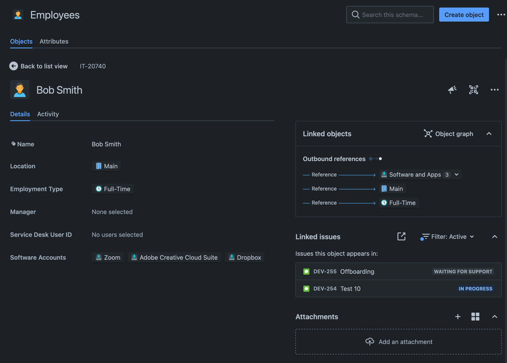

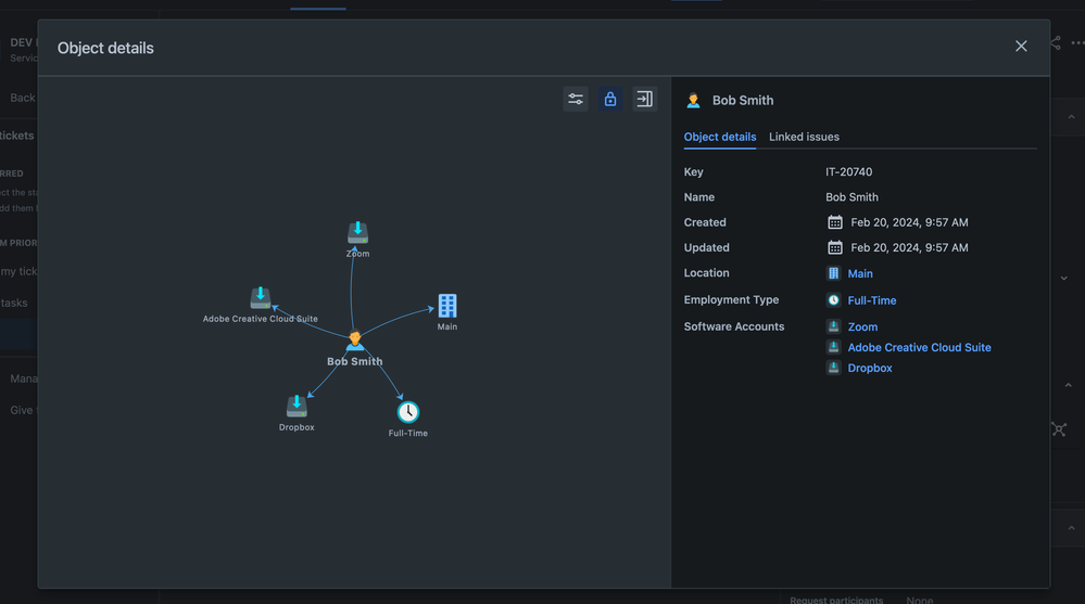

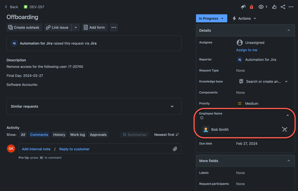

So far I've been able to create the HR Form and associate the Employee Name field with the Asset Object that is the employee. This allows the Asset (Employee) to display within the Details section of the request. It also provides a link to view the Object Details, which contains the information I'm looking for (Software accounts).

I would like to pull the name of the Employee (asset) to display in the Description field. When using {{Employee Name}} to call the asset, I can only display the Object ID, but not the actual name of the Object.

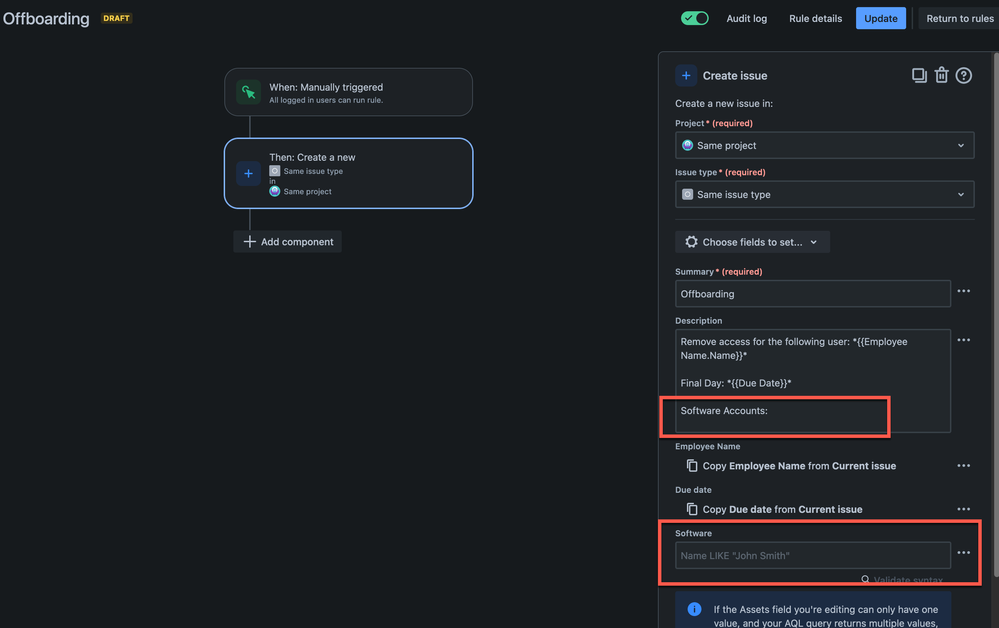

Thank you so much. I was able to successfully have the name added to the Description field. I really appreciate your help.

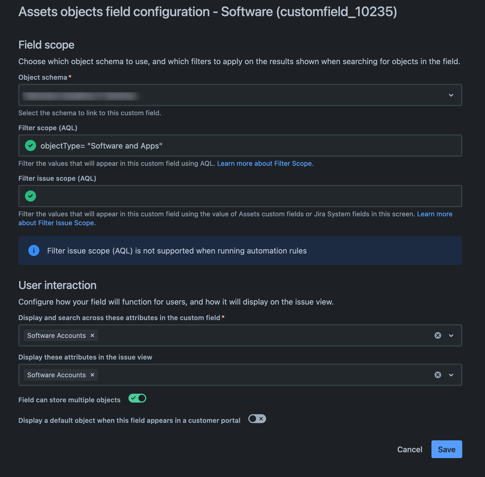

However, I simply cannot get the Software attribute to populate - either in the Details or Description based on the suggestions you provided. I am absolutely stumped on how to get the Software Accounts associated with the Employee to display in a request created by Automation. I'm wondering if I configured the Custom Field incorrectly for my desired outcome.

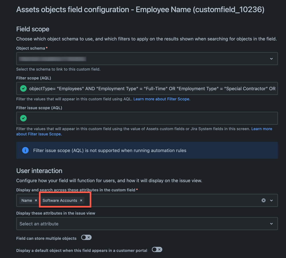

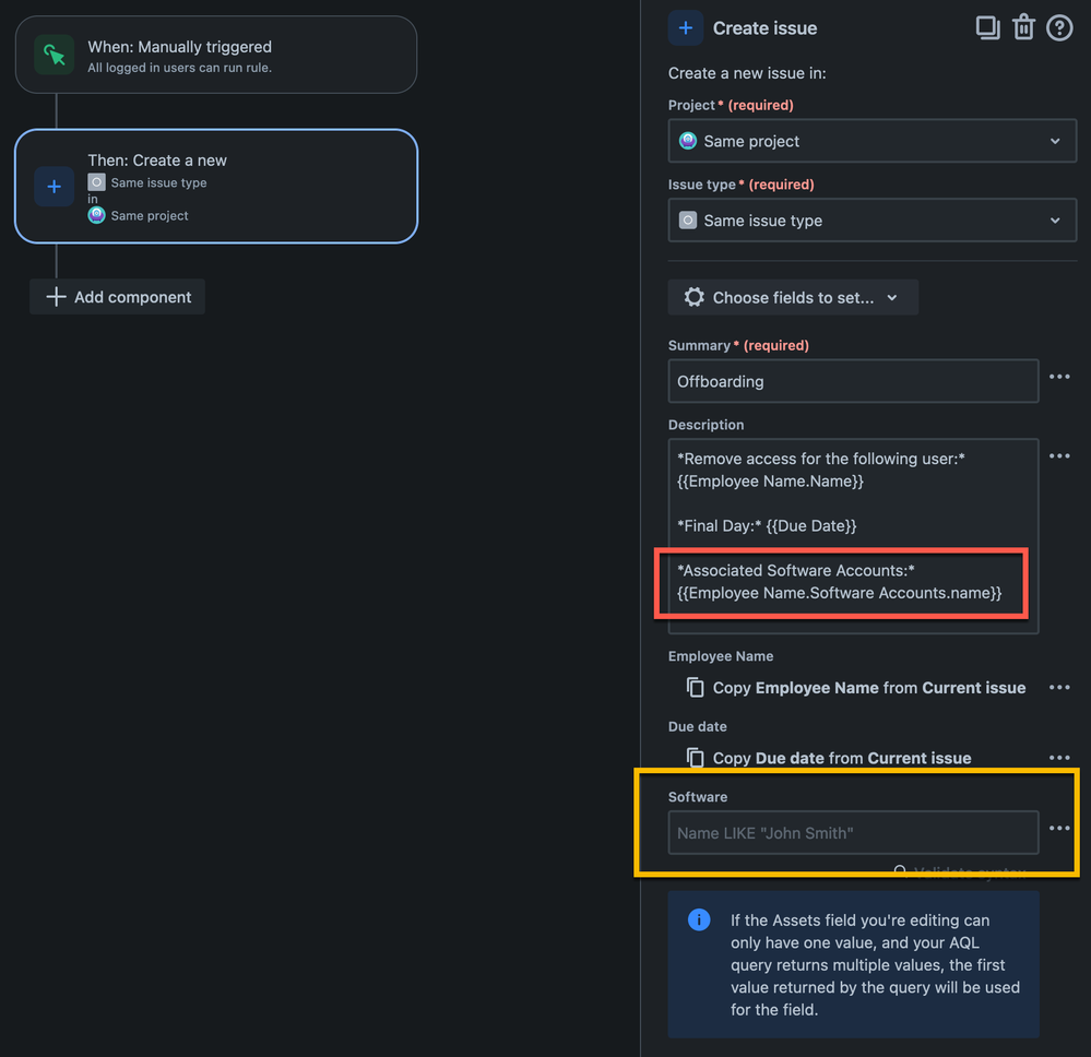

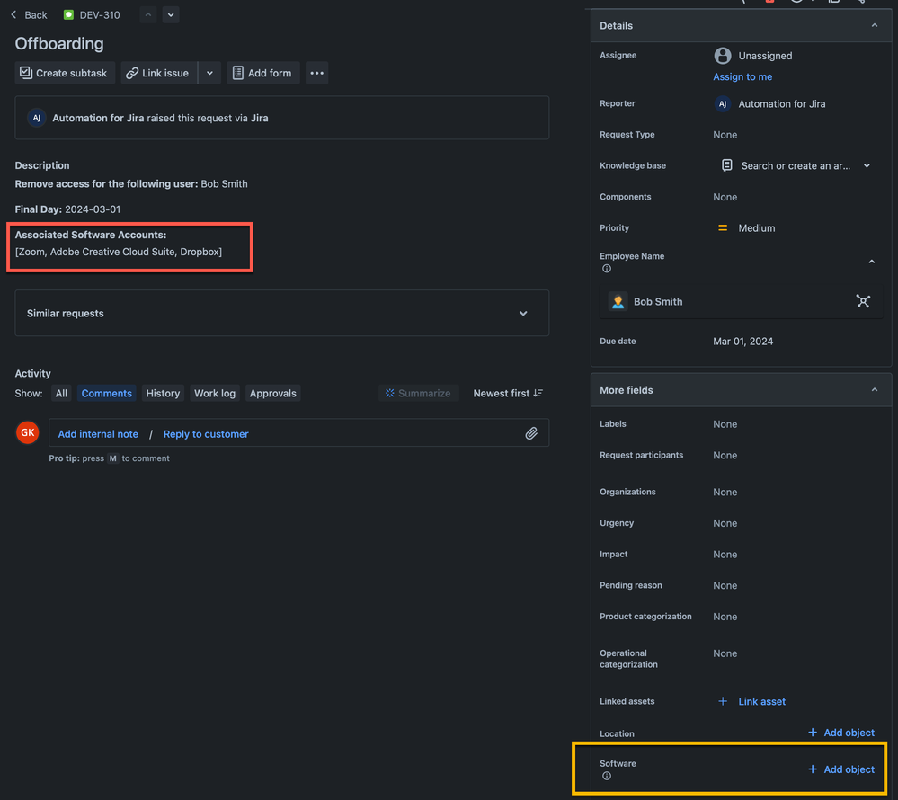

I was able to display the Software Accounts within the Description field, by adding the "Software Accounts" attribute to the Employee Name custom field.
One strange thing I can't figure out though is why the results are appearing in brackets - [example, next example].
Also still can't get the Software custom field to display on the request. I've put in every value I could thing of or found online, and it just won't display anything.
