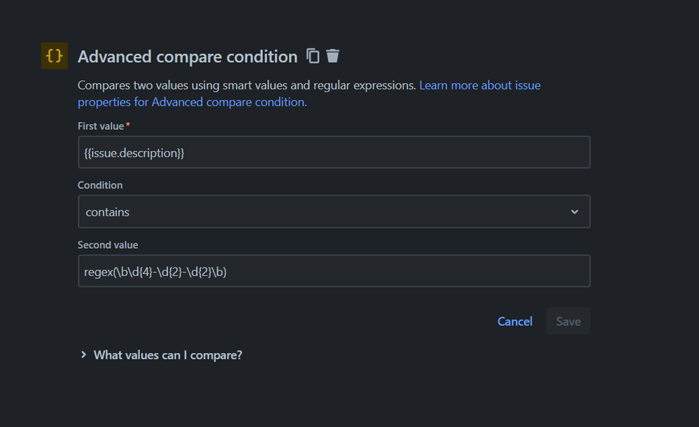

Hello,
We're wondering if someone could help us further with the following challenge :)
We're trying to capture a date in the description field (Effective date: 2023-08-28) and use this as the due date. Sadly we're unable to figure out how this works.
We're starting with the Advanced compare condition.
{{issue.description}}
Contains
regex .*Effective date: ([0-9]{4}-[0-9]{2}-[0-9]{2}).*
And this will not work, of course we tried many options here but are still unlucky.
Who could help us further In this case :)

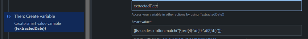

Your Due Date would be populated like this:
{{issue.description.match("(\b\d{4}-\d{2}-\d{2}\b)")}}

Hi @Mark Segall
Could you tell me what's wrong in here?
Mark Segall
August 29, 2023
There's a specific condition in the dropdown for Contains Regex.  Use that and remove "regex" from the second value field.
Geoffrey Jonkers
August 29, 2023
Ahhh gotcha. I'll play arround with that one :) Thanks!

nest step for us is changing the layout. from yyyy-mm-dd to -> mm-dd-yyyy (for DueDate)
 We have this;
Follow with
a new variable which is
{{extractedDate.subStringAfterLast("-")}}-{{extractedDate.subStringBeforeLast("-").subStringAfter("-")}}-{{extractedDate.subStringBefore("-")}}"
