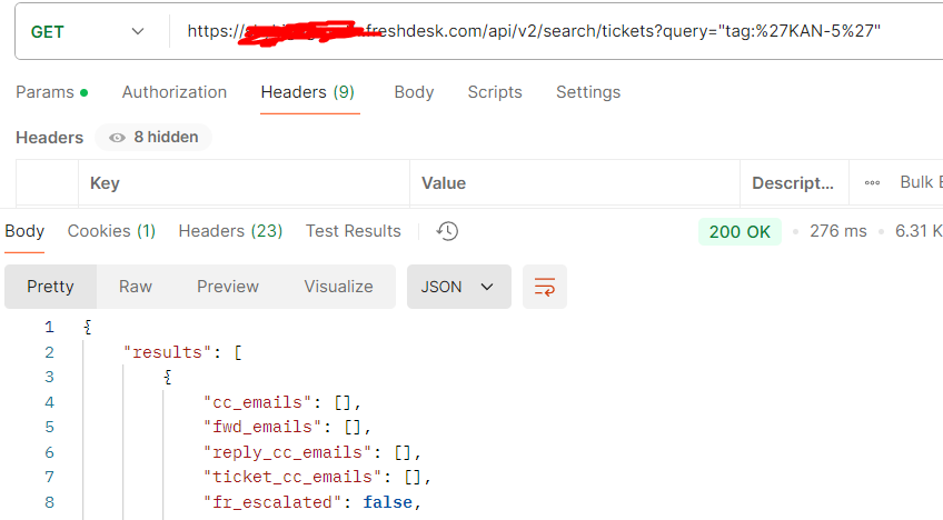

FD provides a GET endpoint for retrieving ticket information when using the proper query.
I am using the query parameter in the GET endpoint, and it works as expected when tested in Postman, but in jira automation I always encounter an error.
GET api:
https://test.freshdesk.com/api/v2/search/tickets?query="tag:%27{{issue.key}}%

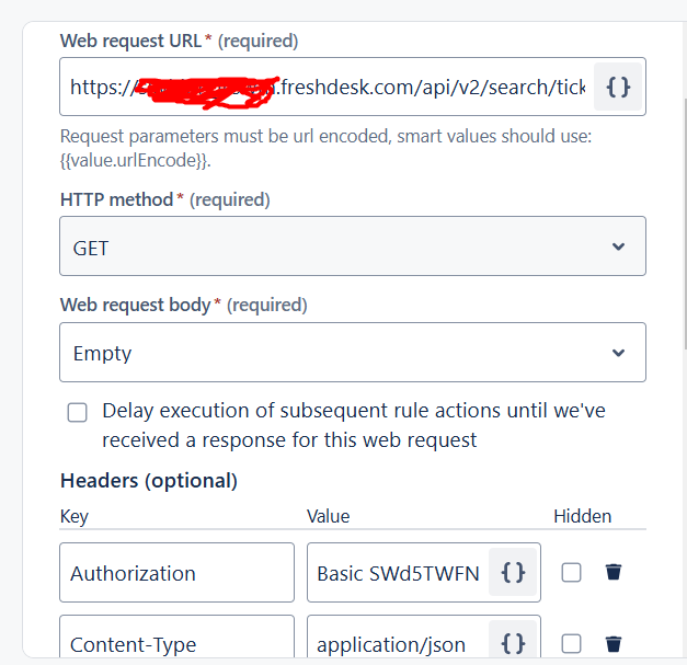

I am using the correct headers for content-type and authorization

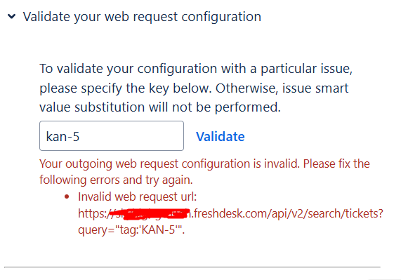

Error in Jira is:
Your outgoing web request configuration is invalid. Please fix the following errors and try again.
Could you help me understand what might be causing this issue?

What if you replace %27 with the right character?
%27 is '
So the call url would be: https://test.freshdesk.com/api/v2/search/tickets?query="tag:'{{issue.key}}'

Hi @Marc -Devoteam- , thank you for hint, but it is same

@Marc -Devoteam- I managed to solve it!
the query should look like this:
query=%22tag%3A%27{{issue.key}}%27%22

So the Freshdesk API needs to have special characters in a call converted to HTML encoding.
That's not mentioned :(.
Might be something to raise to them.
