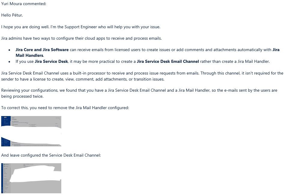

Pétur Björn
May 22, 2020
Hi Petter
Got this from Yuri:
I followed his advice and I´m gonna see how it goes
Like Petter Gonçalves likes this
