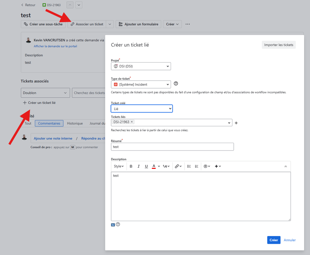

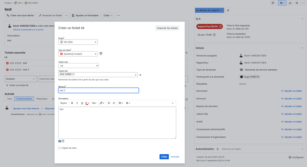

Kevin Vancrutsen
August 29, 2025
It's from the agent view. When you create linked issue, you can't see the request type field. If you proceed the creation of ticket, the field is empty. I want a rule to set the de request type automatically when a issue is created like that

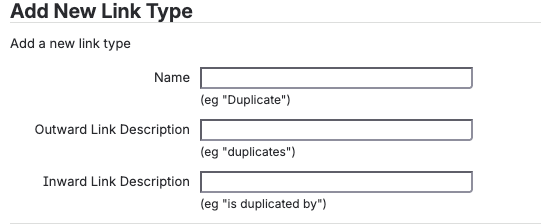

Nikola Perisic
August 29, 2025
Work items are not meant to work in that way. Work item links are based on the inward and outward linking descriptions.Screenshot 2025-08-29 at 10.06.39.png
Work items are not the same as Request types. Rather request types are dependant on the work items.

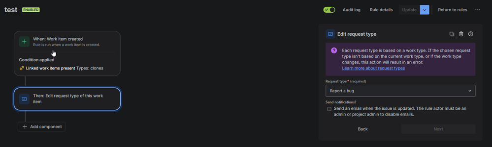

Marc -Devoteam-
August 29, 2025
HI @Kevin Vancrutsen
@Nikola Perisic is right here.
Then you could create an automation after this action.
That fires on work item creation and and set condition that apply, based on link type and then use the set Request Type action.

Kevin Vancrutsen
August 29, 2025
Well, thanks for ur reply. I will clarify my request. When one of our agents processes a ticket, we may need to create a child ticket, and we use the “create linked issue” feature, which automatically links the two tickets together. When creating the child ticket, the window does not allow you to choose the request type for the selected ticket type (we have ticket types such as incident, service request, change, etc.).
I am happy to automate this task, but I want it to be used specifically and only for this case. That is why I am looking for the most suitable trigger.

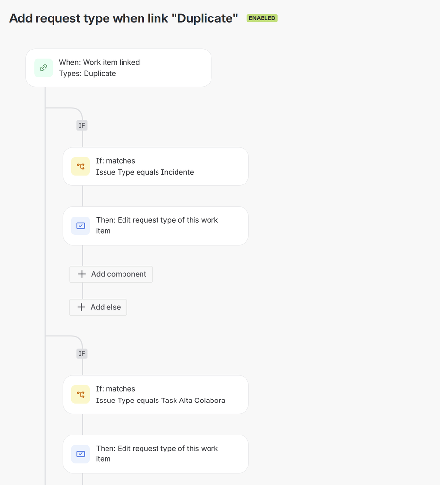

Pedro Olmo
September 3, 2025
Hello @Kevin Vancrutsen  @Nikola Perisic ,
I’m adding an automation so that when you link a new ticket in my example with the link type Duplicate, if the issue type is either Incident or Task, the request type is automatically updated.
Let me know if it works for you or if you need anything else.
Regards

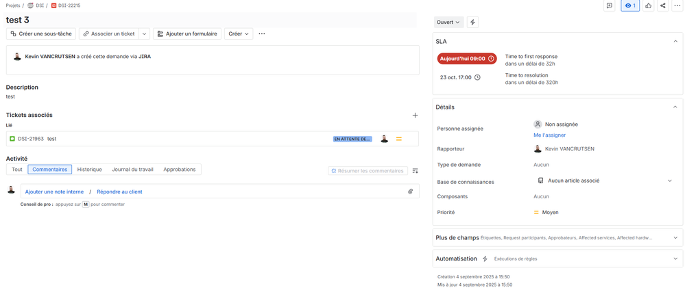

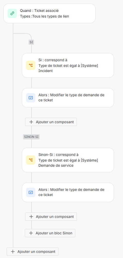

Kevin Vancrutsen
September 4, 2025

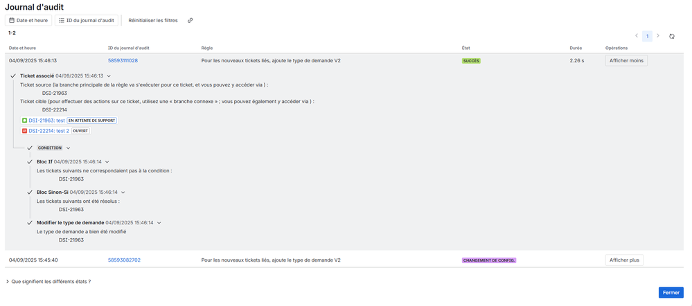

Hello @Pedro Olmo Thanks for reply.
I test it but it's not working :
Here is the log :
I have a ticket "test" DSI-21963 and when creating a linked issued :
Open the nex ticket "test 3" and request type still empty :
Is there something I'm missing?
Pedro Olmo
September 4, 2025
Hello @Kevin Vancrutsen ,
Notice in the log that it is editing ticket DSI-21963, which is your source ticket. From there, you create DSI-22214 and link it back to DSI-21963 in your creation screen. Please review the automation trigger to ensure that it only fires when the link type is "Lié"
Regards.
Duc Thang TRAN
August 29, 2025
Bonjour @Kevin Vancrutsen
Ton automatisation se déclenche lorsqu’un utilisateur de ton projet crée un ticket via la fonctionnalité Linked issue.
Si le besoin est de mapper ce ticket avec un Request type de Jira Service Management :
  • Tu n’as pas besoin de créer une branche sinon ca va faire les actions sur le ticket du branche et pas ce ticket
  • je suggere d' ajouter une condition pour vérifier si le ticket possède un lien de type (afin de cibler uniquement les créations issues de cette action).
  • Ensuite, ajoute action Edit request type  et lui attribuer le Request type de ton projet.
⚠️ Assure-toi que le type de ticket correspond bien au Request type, sinon l’automatisation renverra une erreur.
