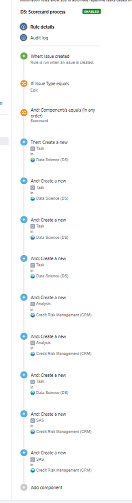

As requested, the automation screenshot is attached. It's pretty basic as we have a specific process we follow however the last ticket created has a specific label attached to it and once the ticket with the specific label is set to done i need to start the countdown.

Hi @Arturs Kalnins , thanks for sharing the automation. Indeed, that is pretty straightforward and appears to be working for you. Now as I understand it when a certain issue is moved to done status then do you want to create a new issue 30 days from that point, correct? The rest of my input is based on that assumption.
First it is important to note that as of today you cannot schedule an automation from another automation. Now I'm not exactly sure why you want to delay, the creation of the issue. I am wondering if it would be possible to actually create the issue immediately when the other issue was moved to done and simply "hide" the issue until 30 days later. In your case, I don't know exactly what to propose in order to hide it, but let's put that aside for moment and assume that can be achieved.
If you had a rule that triggered when your specific issue is moved to done, then create a new issue and give it a label such as future-issue. You could have another rule that was scheduled to run daily with a JQL qualifier for open issues with the future-issue label. If the created date is equal to today's date -30 then you could make this issue visible. Again, I would I need to know more about your situation to understand if we could hide an issue and then later expose it. For example, let's say we want to hide it from your board. In this case, you could exclude any issues that had that label and then in you're scheduled automation, when it has reached that 30 day mark, you would remove that label. I hope this is making sense. If not, please let me know.

My point was to creat the issue but exclude from your board until 30d later. You could do this as follows:
  1. edit your board filter to exclude issues that have a label of "30d-later"
  2. when the specific issue transitioned to done trigger a rule which will create the new issue an add a label of "30d-later".
  3. create a second rule that is scheduled to run daily qualified by JQL "labels = "30d-later". Condition to check if the issues returned were created 30d previous. Action to remove the label which will result in the issue now appearing on the board 30d later.
i hope this makes sense.
