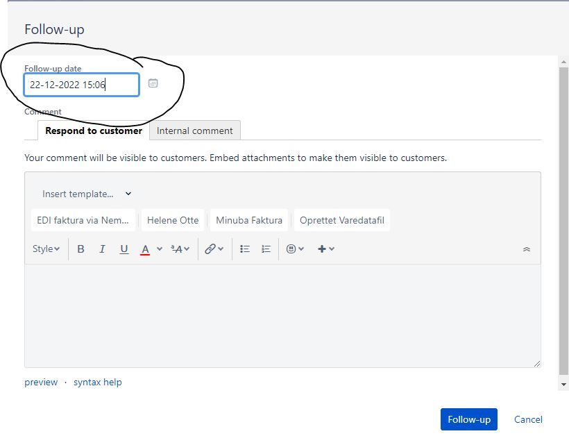

The follow-up date will not be calculated it is a date we can choose when we respond on a task see attached picture.
The date is not visible for the customer.

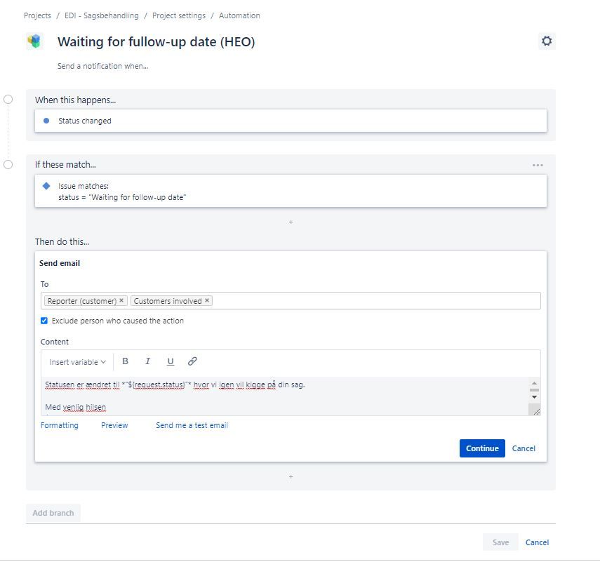

I would like it to appear in the customer notification I send to the customer, like the “${request.status}”.
So it would be like this if I choose follow-up date add a date and click follow-Up - I do not have to write anything to the customer - unless I have something personal to add.
Example:
The status has changed to "Follow-up date" ( “${request.status}”. ) I will look at your case again the "follow up date"

I think I am following you, but I would not use the Automation for Jira functionality and not the built-in automation of the project.
You would go to Settings (gear icon) > System > Global Automation
Then create the automation rule there.

Let me see if I follow you. You execute a transition, which causes the pop up to appear above. You put a date if the Follow-up date field. Then you click on the Follow Up button.
Correct?
If so, then I would create a new Automation Rule for the notification email. Create it with a Field Value Change trigger and select the Follow-up date field.
Then add a new action for Send Email. There you can select the Reporter in the To: field.
In the body of the email you can use something like:
Dear {{issue.reporter.displayName}}:
I will follow- up on your task on {{issue.Follow-up date.longDate}}
Give that a try and see if it works for you.
