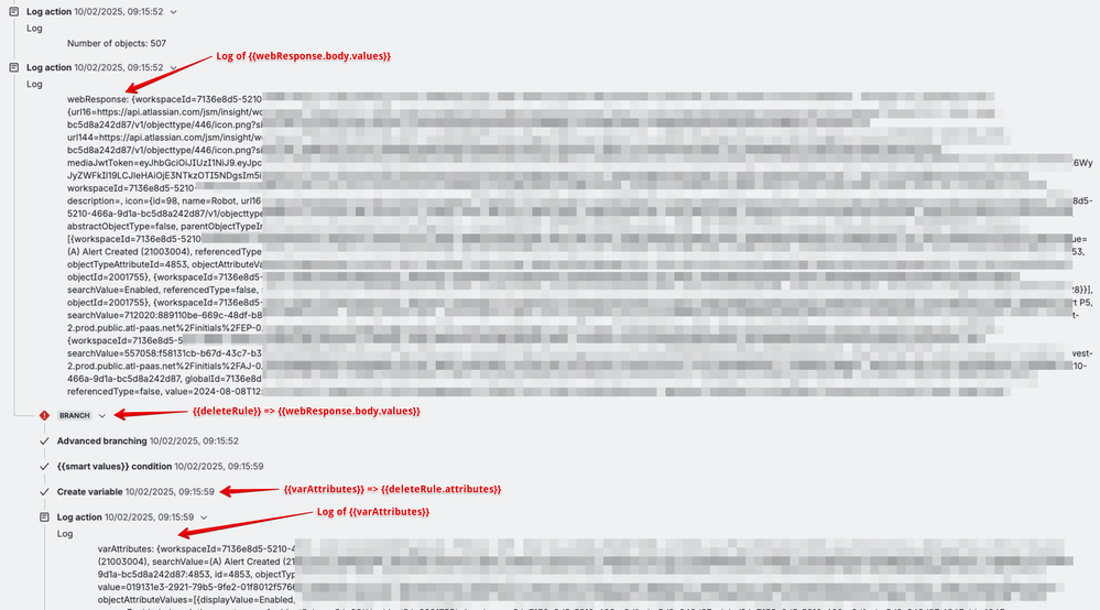

I did try this but the jsonStringToObject()-function throws an error like this:
The weird thing is that the sub-array: varAttributes is not in JSON string format what I can see. It seems to already be in JSON object format, i.e. the same format as the original webResponse. Checkout the log:
But when I try to iterate over it using:
{{#debug}}{{#varAttributes}}{{id}}{{/}}{{/}}
I get nothing, but when I replace the {{id}} with {{.}} I get the entire array. That tells me that there is only one "object" in the variable.
It feels that the textual format is correct but the automation is not treating it as a proper format that works with the dot-notation.

That last bit could also indicate it is text and not JSON...
The audit log writes text only, and so uses some equivalent of __toString() function when trying to log values.  Your test trying to iterate over {{varAttributes}} indicates it is a single text value.
And, also please note: I recently learned the {{#debug}} ... {{/}} syntax cannot be used in the source, smart value for an Advanced Branch.  It appears the act of logging collapses it all to a single text value.  If you have a debug in the branch source, please try removing that.
