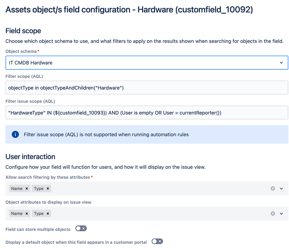

Yes, this is possible. In the configuration of your "Material Name" custom field, you can filter the values based on the selection of another custom field on the form. You need to use "Filter issue scope (AQL)" field for that.
Here's something similar where I filter the values in the "Hardware" drop down, based on the selected "HardwareType" value (customfield_10093), and the currentReporter().
